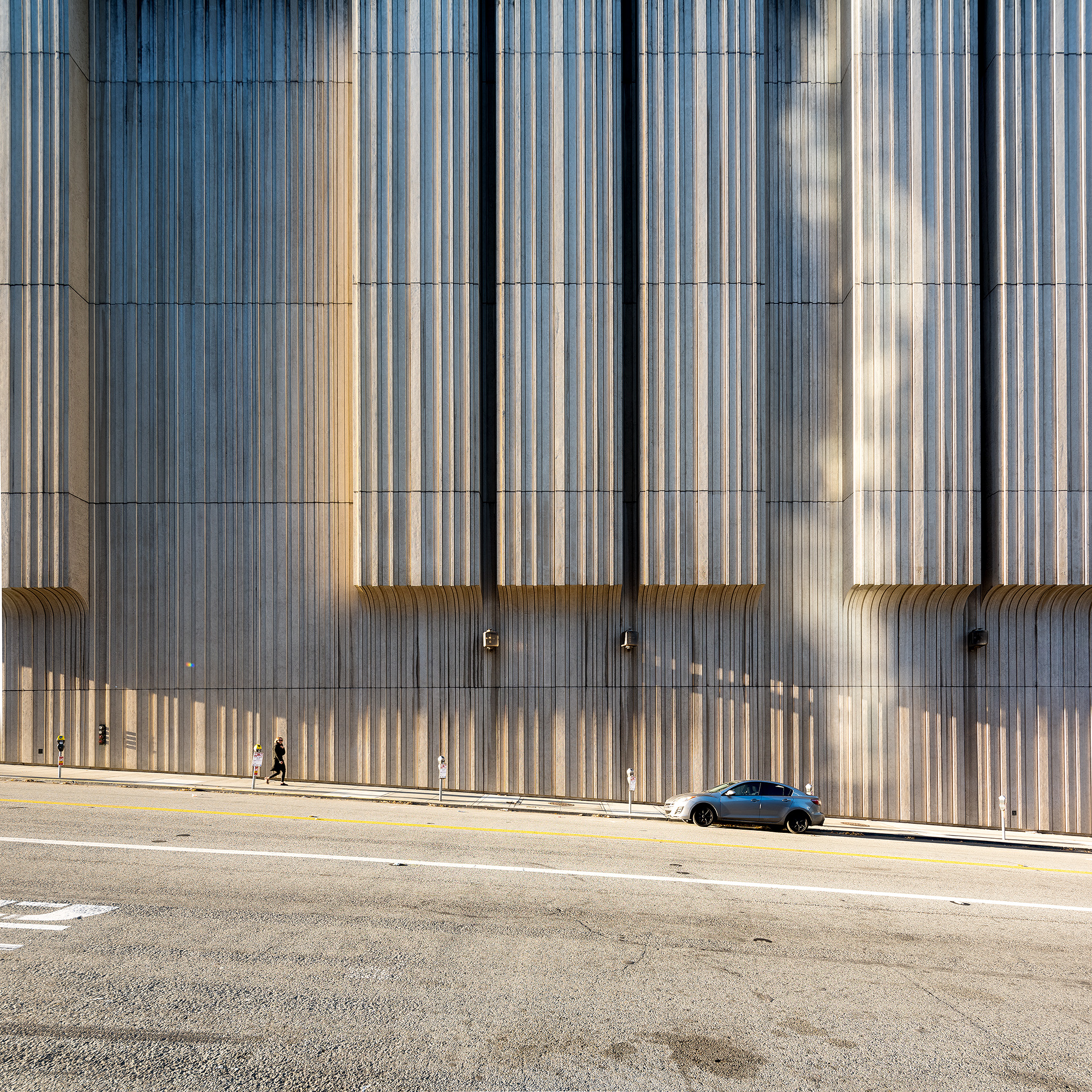

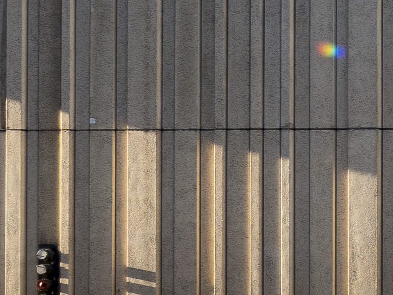

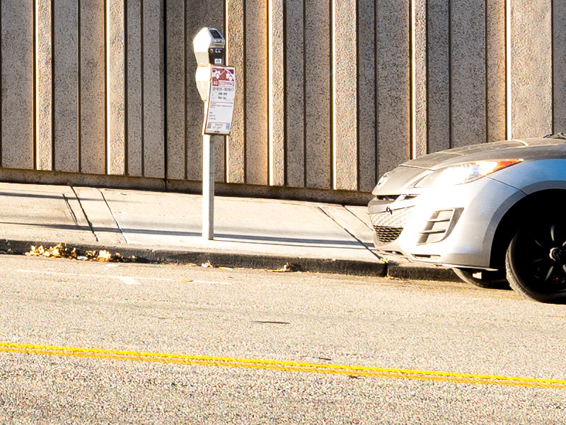

lloyd chambers' observations on the lens are useful with regard to field curvature and focus shift. i took some time this morning in the dead of our local winter to experiment a little with stitching using the dovetail clamp on my camera and tripod as an ad-hoc "rail." full shift down with the camera slid 12mm "up" in the clamp, then centered, then the opposite, and parallax is neatly avoided for anything at a reasonable distance from the lens. the resultant 70ish mp images are not pin sharp all the way to the edges at the level of individual pixels, but even cut in 1/2 in each dimension they are big files and tons of detail is apparent.
here's a square take from just two frames, capturing a number of curious moments of light both direct and reflected on the rusticated concrete facade of a telecommunications building which has now found itself in the middle of high-rise residential towers.
this 100% crop from the extreme left side with only a bit of sharpening in ACR shows the slight softness that f/8 and perhaps a slight focus error show. of course, keep in mind the scale of this relative to the overall image.
and compared to a point nearer the center of the frame:
the sharpness of areas in the road further towards the side and front suggest that what's happening is both the natural loss of sharpness towards the edge of the image and the "plane" of focus curving towards the camera at the edges.

michael, thanks for the close-up example.
Thanks, the overall image looks good, but the uneven sharpness looks strange, yes probably focus is off,,, A lens this sharp is very demanding especially if you attempt to stitch,,,
