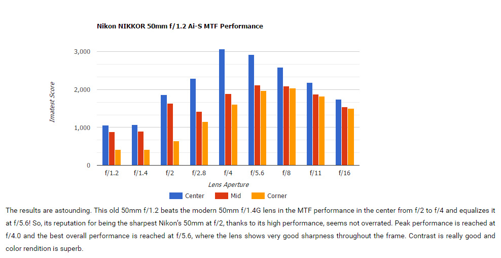

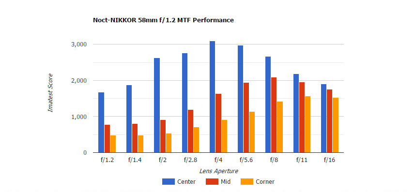

I have one of the 55/1.2 K(Ai'd) and, though I have never shot the 58mm Noct, I can tell you that the 55/1.2 has pronounced spherical aberrations wide open that make the images even dreamier than the famous look of the old manual focus 35/1.4 wide open.  It really qualifies as a 'special effect' IMO.
Thanks for that info. Very descriptive and helpful.
I can't imagine the famous 58mm Noct looks that soft wide open.
I guess it's all relative.
For its time, the Noct was "razor sharp" wide-open ... but compared to the 105 f/1.4 the Noct is as dull as a butter knife.
The Noct isn't even in the same balpark, sharpness-wise, at any aperture, as the 105 f/1.4.
Curiously, once stopped down to f/4 or more, the 55/1.2 K is a very contrasty, "sharp" lens.
The 55 f/1.2 K sounds exactly like the 50 f/1.2 AI-S, which too is about half as sharp as the so-so Noct wide-open ... but rockets to equal the Noct's sharpness by f/4.
The amazing thing is, neither one of these lenses, at their best, can equal the sharpness of the 105mm f/1.4 at its worst :o
  :o 8)
