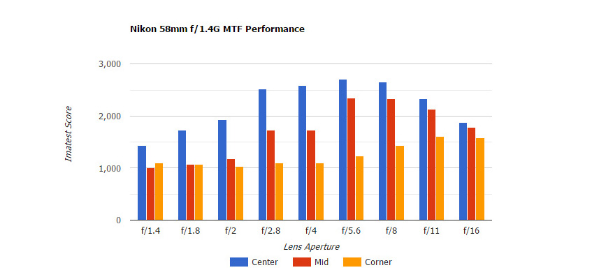

Based on the charts I have read, 58mm AFS 1.4 doesn't ever really get to "great" status, but is pretty mediocre the whole way ...
Based on the charts I have read, it appears the new 105mm f/1.4 ED actually blows away the Noct. Nikkor in at pretty much everything, from low-light performance all the way up:

Actually, I think you can base everything on the charts.
The superiority (resolution) of the 105mm f/1.4 at the widest aperture is nearly double the Noct. at f/1.4 (and the corner resolution is nearly quadruple!).
That is not a 'minor' difference, that is H-U-G-E :o
However, it is easy to imagine a scenario where the Noct might still be the creative choice.
For example, if I were taking a photo of an old man smoking a cigarette, under a foglit streetlight, the Noct's lesser corner-sharpness (and lesser overall sharpness) might actually "set the mood" better than a razor-sharp image across the frame.
I actually think that super corner performance isn't always what you need, especially in a mostly-bokeh, with minimal-subject-focus type of image.
All of these things can be seen, imagined, and analyzed by looking at the MTF charts IMO ...

One can tell a lot from MTF charts if you know how to look at them, mind you, they are mostly computer or simulation-based.
No way can you tell about sharpness transition, saturation or contrast looking on a curve,,,
I believe Lens rentals does a fairly good job when testing lenses, go and google what Robert has to say about the Neo-Noct :)
However; One can tell a whole lot more from the pictures if you know what to look for,,,
