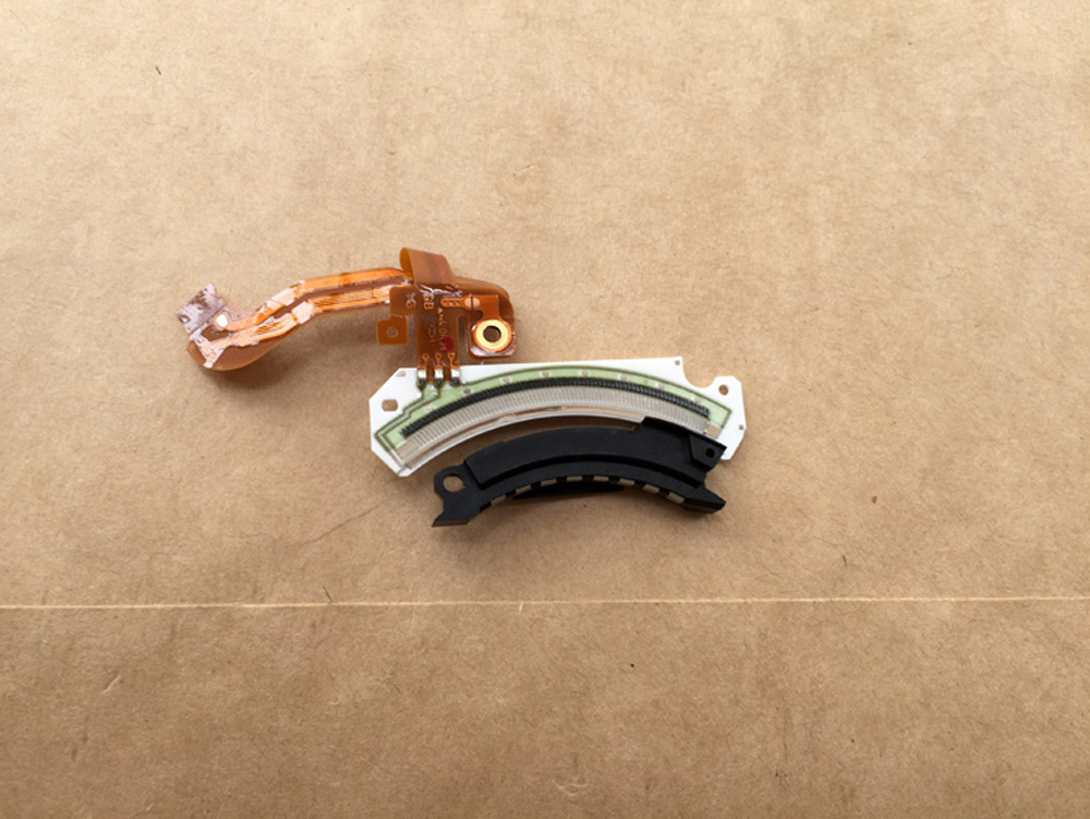

My Df startet to show signs of hard use today. I usually use old lenses with the little wonder. The aperture readings from the mechanical coupling has worked flawless since I started using it, but today it wouldn't read apertures under f5,6. When I turned the ring from stopped down to full opening the reading gradually went down until long after I stopped turning the ring, but stopped at f8 or f5,6. Stopped down, the f22 lenses, read f45. So to get the correct exposure I had to use ISO to compensate. Some insider DIY tips or just use NPS?
Re: Df-wear and tear
« Reply #1 on: December 16, 2016, 17:20:20 »
My guess is that the ceramic plate holding the aperture follower circuitry has developed a hairline crack. The plate sits on the front under the upper part of the camera mount.
Nikon some years ago changed over from a pliable print to the ceramic plate for their DSLRs (only apply to those with aperture followers). Probably cheaper and more "cost effective" (heard that phrase before?), but susceptible to frontal impacts.
If this indeed is the cause of your observed problem, use a 'G' lens and set the aperture through the camera's front dial. Should work as the signal pathway is routed differently.

The G-lenses works fine, but the older lenses seem to be off by a mile :( I think it is time it goes back to Nikon for a full check up. Maybe they can change the rubber and fix all the other quirks it has. Should I change back to the original focus screen before they start to scrutinize it?
Exactly the same thing which happened to my D810! Thus the famous (or infamous) diagnosis of "impact damage". Bjorn is correct about the ceramic thingy and methinks it is quite delicate. Does anyone know if Nikon is using this with all models now?
And perhaps another question - what was the last "pro" model to not use this? Seemed like my D700 was more robust.
And 100% with Bjorn on hoping Nikon has learned something and the DfII will be a better implemented product.
« Reply #14 on: December 23, 2016, 14:31:06 »
Ceramics prints are all in (every model to the best of my knowledge) and waiting for a disaster to happen ....
I agree this is a known and thereby by definition, 'infamous', design bug. Whatever advantage the ceramic print might confer in accuracy etc. is lost by its susceptibility for breaking. Trust me, it didn't take much of an impact to crack the ceramics on my first Df. I am all amazement how fragile and delicate this construction is.
