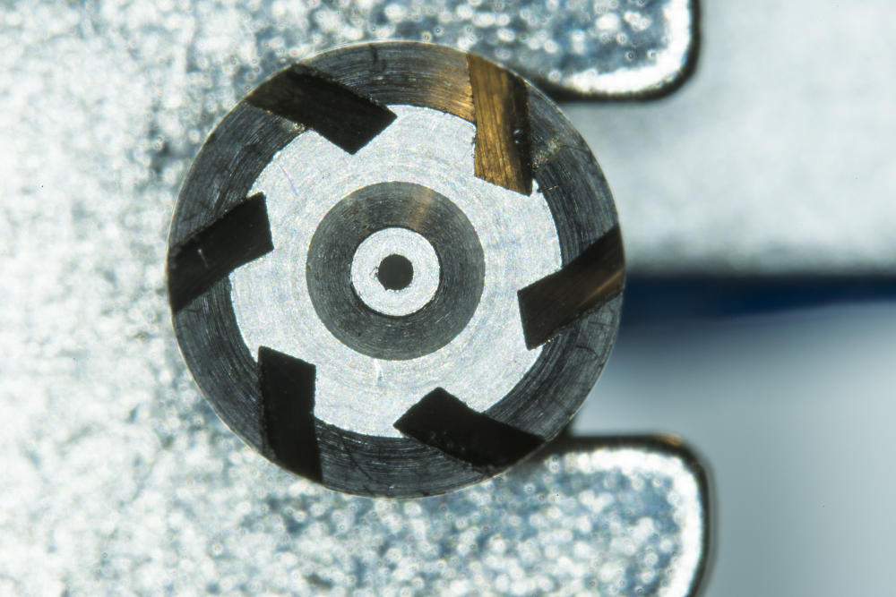

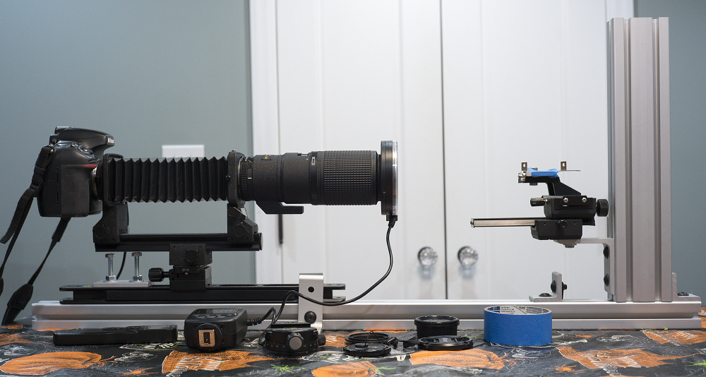

Here's what's working for me:
D800 + 200/4D AF + PB-6 Bellows (200mm extension)
and this gives a full frame image like:
which is more than good enough.
This is a single image at f/22 so diffraction is taking its toll, but I'll back off to f/8 or so and do some image stacking - any recommendations for a basic image stacker that can use manual images?
