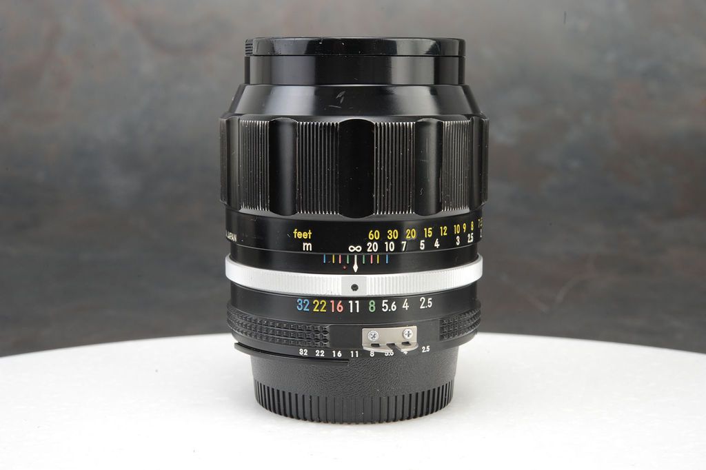

That 105 is just perfectly done!
  • Posts: 1558
Re: How to get non-AI Nikkors converted?
« Reply #33 on: November 23, 2016, 23:47:15 »
The 105 looks amazing. No screw holes from the aperture, the AI and EE-servo tabs look perfect, I wonder how it was done?
Is that a join line below the scalloped grip? Maybe the entire lower part of the aperture ring was cut off and new AI part was fabricated and glued on ...?
It looks to me like the original ring has been turned to a parallel diameter.
Then a new ring is made and fitted to the original with what might be a shrink-type fit. The new ring is heated slightly causing it to expand and then allowed to cool over the existing ring.
The other option would be for the mating diameters to be machined to close-clearance tolerances and then assembled with some sort of retaining compound like LOCTITE 601.
I like the second option better, less chance of crushing the existing ring.
  • Posts: 6625
« Reply #35 on: November 24, 2016, 08:03:18 »
Well if it was done correctly it's Silver soldering or brazing, very difficult but strong and as good as the original, even stronger.
The other option is two component Epoxy, acceptable but not good at impact resistance,,,

That 105 is certainly a nice job.
The other one reminds me a bit of a different solution I did long long ago.  In about 1970 I bought a cheap Nikon mount 200 that had no meter coupling at all.  For that one, to use on my old Photomic F,  I made a similar ring with a meter claw on it.  Since there were not even any claw holes in the aperture ring, the added ring was clamped at the bottom with a screw.  A lot can be done with a good piece of aluminum.
