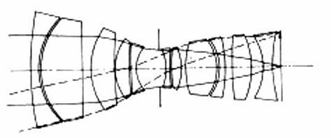

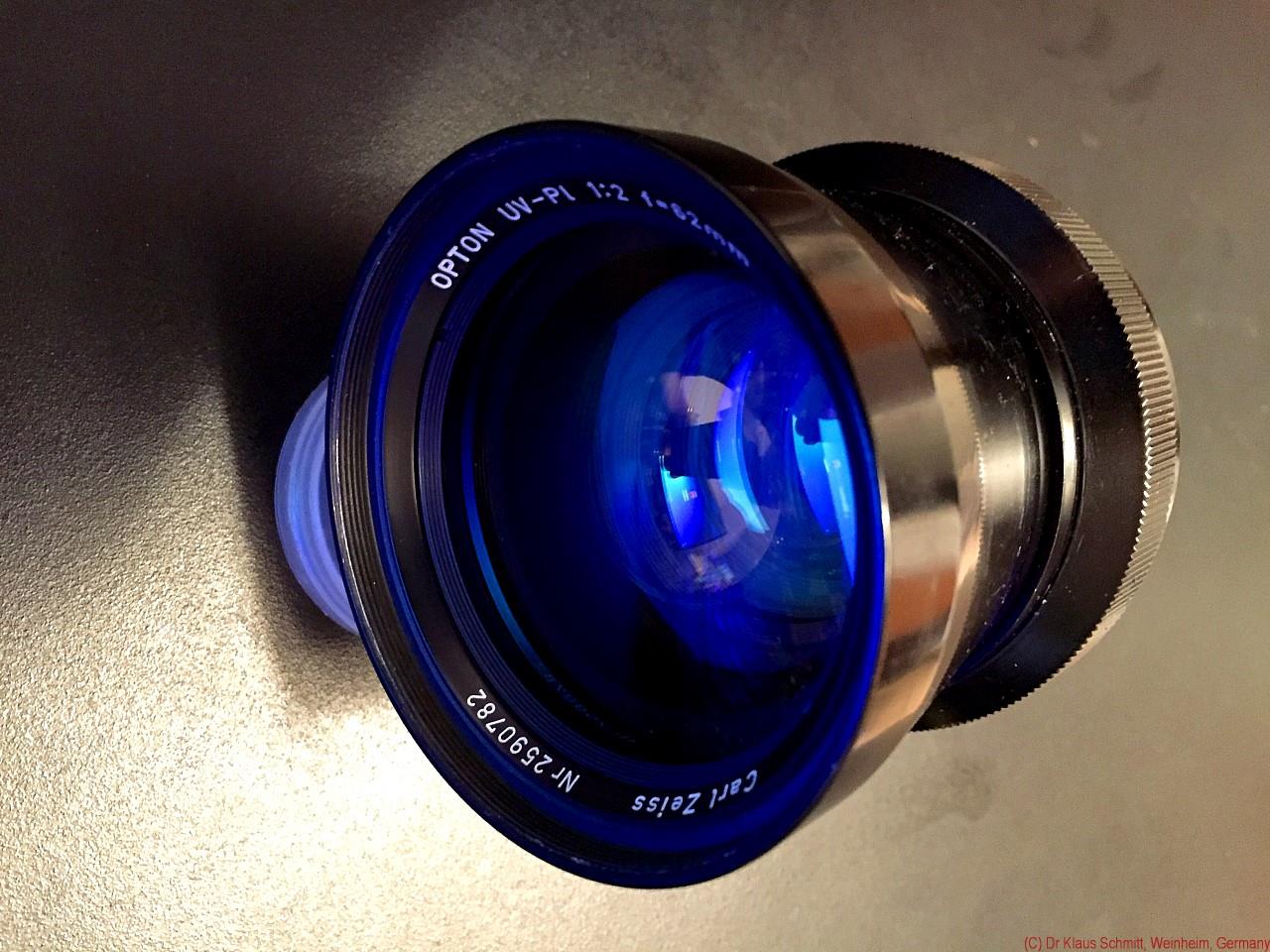

Well, it has been a while, just noticed that the famous UV-Planar f2/62mm has not been mentioned....(which will not be sold despite letting go a lot of lenses as there are only two known to exist)
This is its rather elaborate 11e/11g optical scheme, which was computed around 1970 by Prof. Glatzel, ZEISS' Designer in Chief at this time:
All that based on a NASA demand for an extraterrestrial lens which covers UVC - NIR (200 - 700nm), but with a speed of f2 using CaF2 (Calcium Fluoride) and synthetic Quartz (fused silica).
And this is how it looks as a finished lens in barrel with adjustable iris built in (the blue light was just a reflection from my PC monitor):

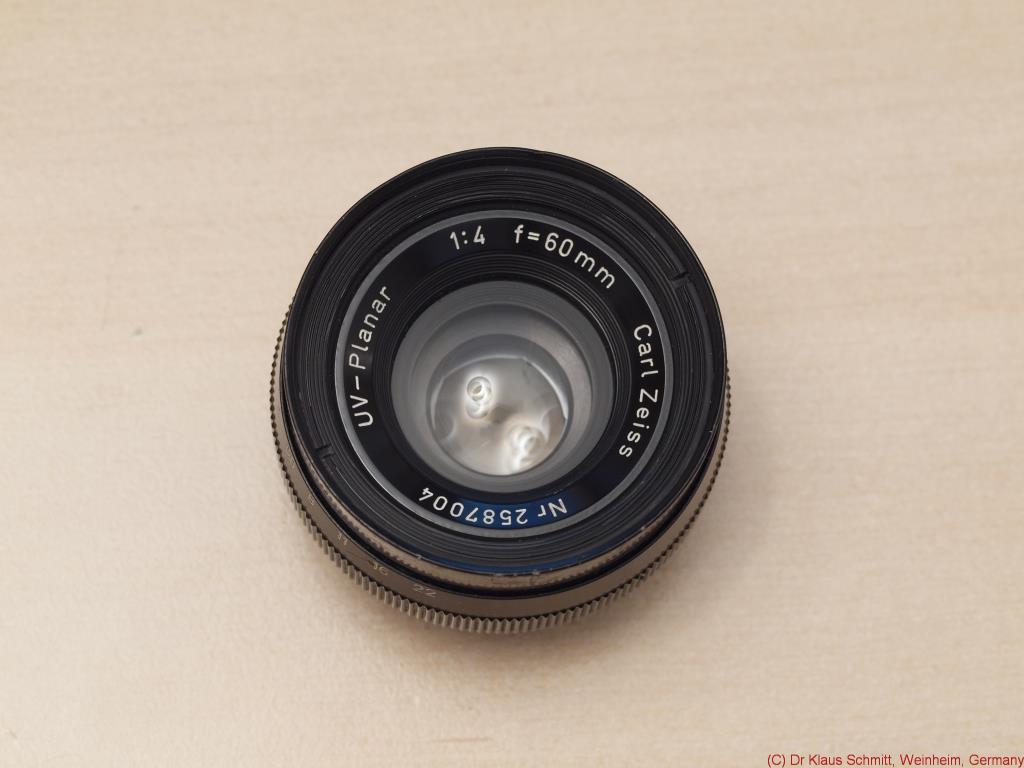

Here now the ZEISS UV-Planar 4/60mm, once made for producing finest rulers (micro size) using UV-light...
and using it for photography....(wide open at f4):
and at f5.6:
