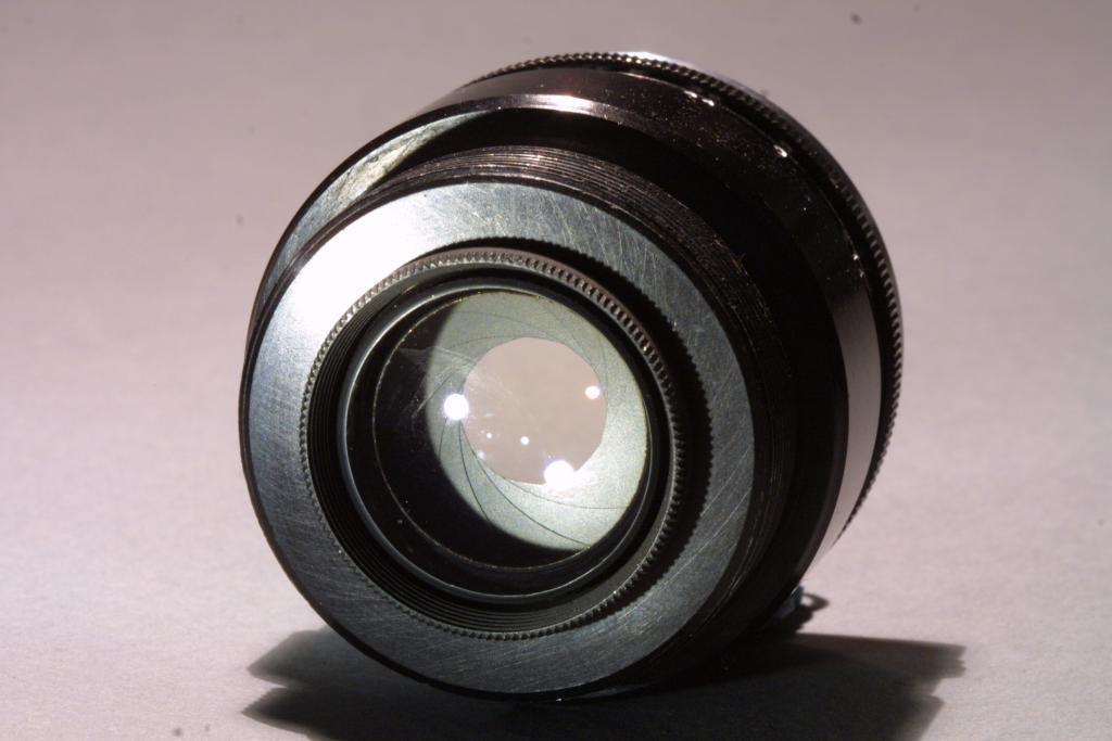

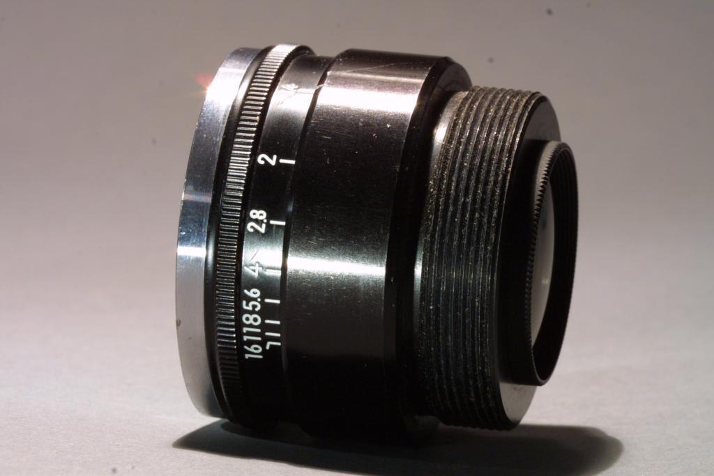

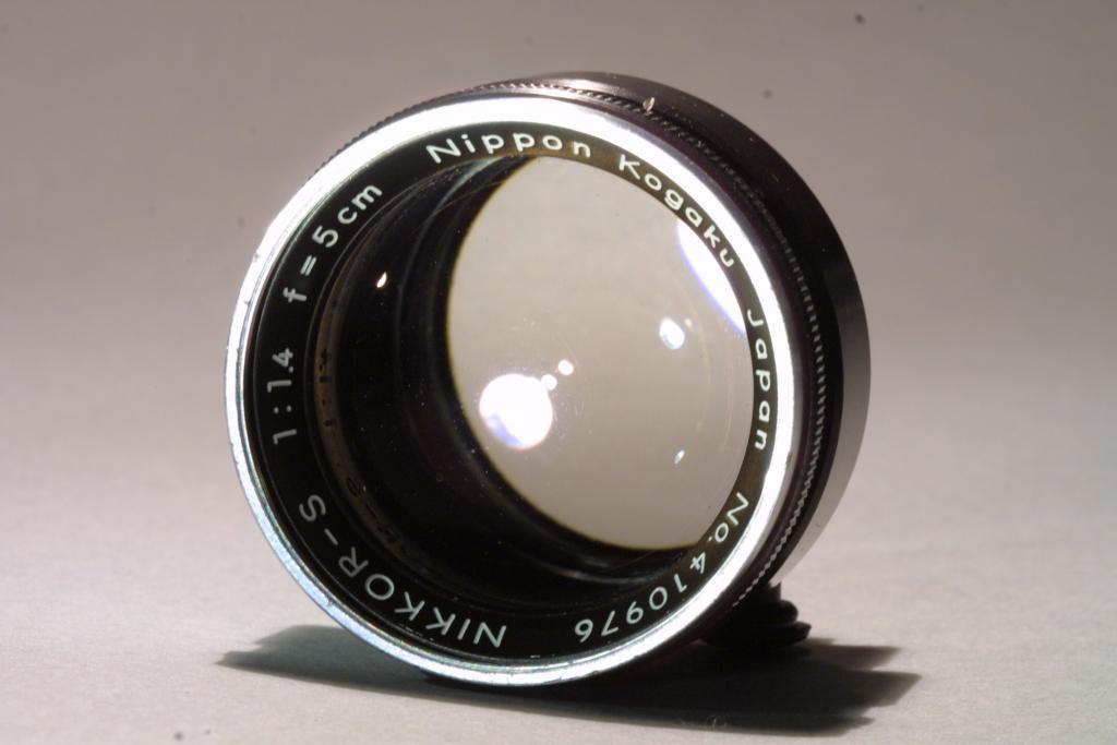

« Reply #41 on: July 14, 2019, 15:10:50 »
Btw. the "father" of that lens most likely was this one (which was used for Los Alamos experiments then...). Note the very unusual thread mount...
Thank you, Klaus.  That could be the same optics as the normal Nikkor-S 50/1.4 with the distance between the front and the rear groups adjusted for closer focusing range.
