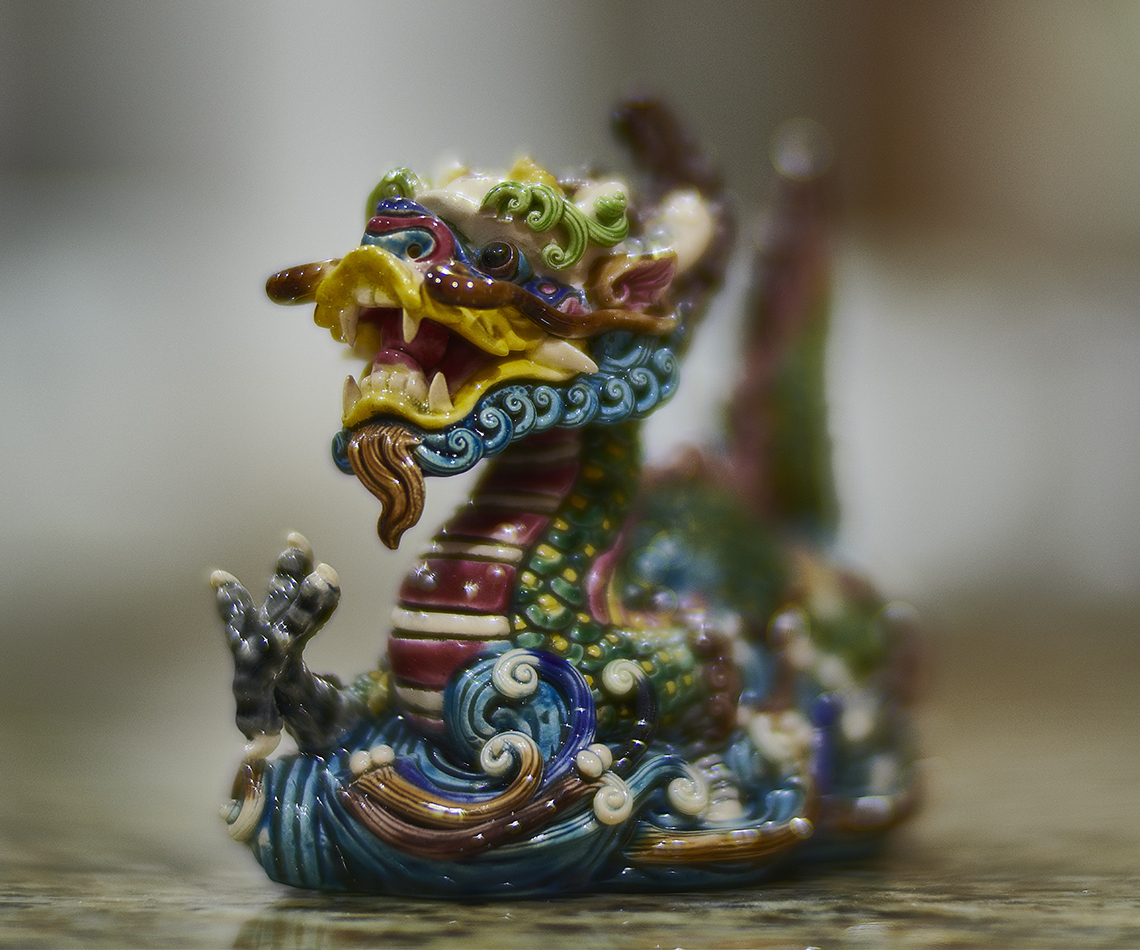

« Reply #16 on: December 21, 2018, 23:19:58 »
Nikon D850 ,Rodenstock Heligon 100mm f/1.6
1/30s f/1.6 at 100.0mm iso100
cropped
added PK-11a ring

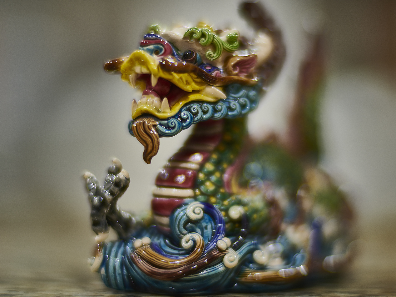

  • Posts: 10026
Re: 100/1.6 XR-Heligon
« Reply #17 on: December 22, 2018, 17:41:02 »
Full frame with only the k2-ring on the Heligon
D850    100/1.6  1/100  iso3600
  • Posts: 1300
« Reply #18 on: December 22, 2018, 22:32:22 »
nice one!

  • Posts: 13300
« Reply #29 on: January 18, 2019, 19:16:45 »
added PK-11a ring
WOW, Bob. I really like this very much. An exceptional camera with an exceptional lens.
