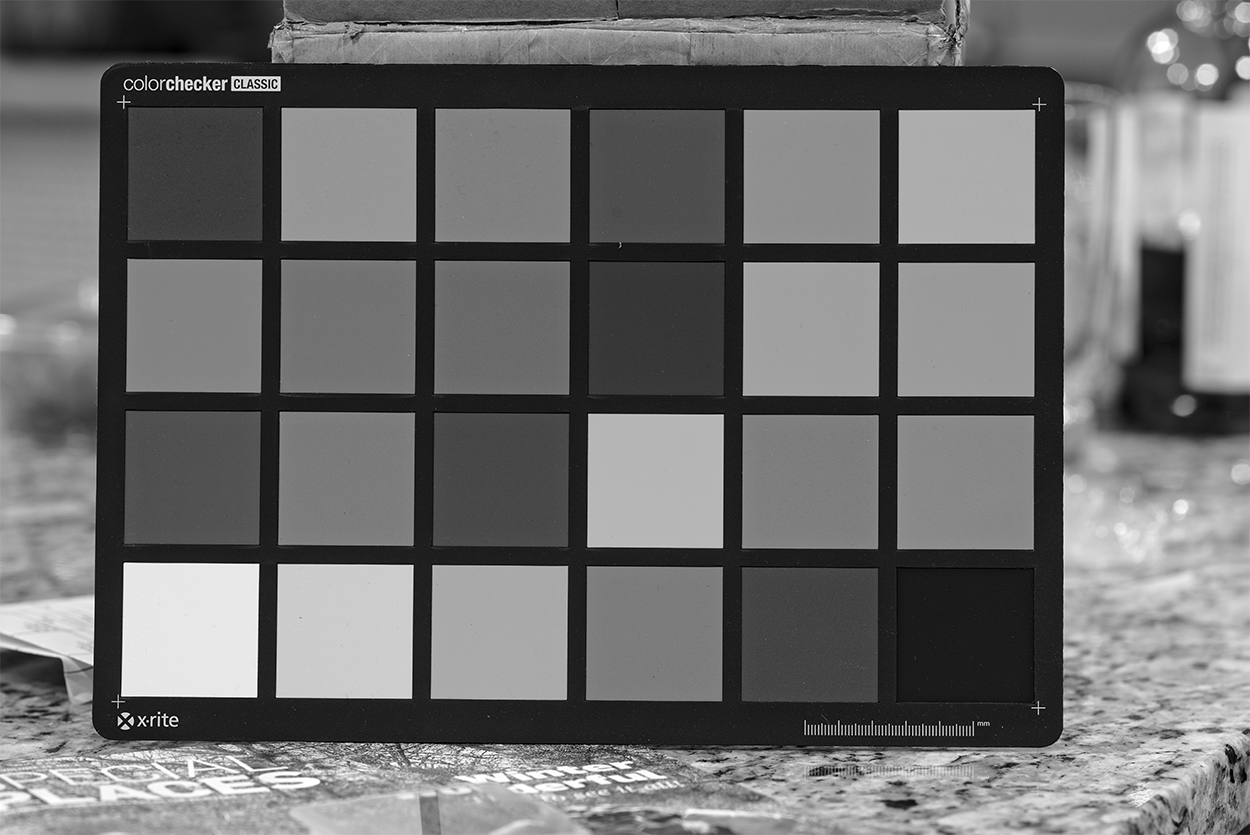

Well.. I just received my D800 monochrome conversion from MAXMAX.com, the following image was using D65 lighting, scene referred WB, BG38 filter. Using DarkTable software, turning Demosaic off.  Some image leveling and minor contrast adjustment.
Nikon D800 ,Carl Zeiss Apo Sonnar T* f/2 135mm on Tripod
1/8s f/5.6 at 135.0mm iso250

I didn't attempt this myself at all.. MAXMAX.com as i mentioned in the first post performed the conversion.  D800 functions fine.. i use live view for exposure and take that measurement to perform preset WB to level the channels. Since this is a BG-38 filtered version (replaced the UV/IR cut filter with BG-38 glass) this will pass UV.. and i am wondering why there is a slight increase in the blue channel - except the D800 WB algorithm coefficients are designed for color inputs.
