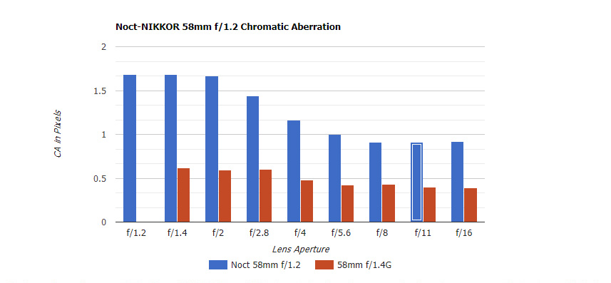

The Voigtländer beats any Nikkor 50-58mm lens in this regard, and also has better CA correction than any Nikkor 50-58 lens:
Voigtländer Nokton 58mm **CA** (Version I, not II)
Nikkor 58mm f/1.2 Noct. + Nikkor 58mm Neo-Noct. **CA**

It is, for sure, sharper than my ex-Nikkor 50mm AI-S wide-open. In fact, it's about as sharp as the Zeiss 50mm Milvus wide-open (the Angry Photographer calls the new Voigtländer Nokton 58mm f/1.4 SL II S "The Best Lens Value Ever.")
