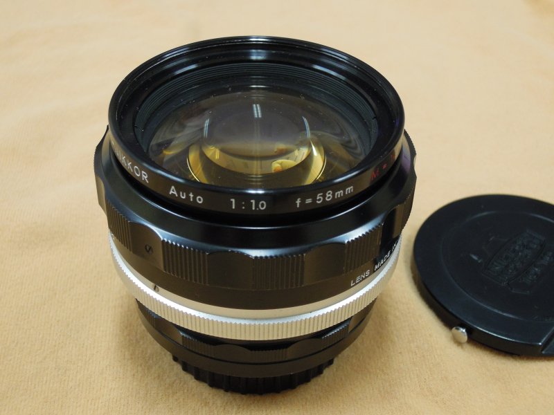

Hello Nikon friends,
The fastest lens in the F mount Nikkor lens is CRT Nikkor 58mm F1.0.
Yes, it is F mount.
This lens appeared in the Nikon Kenkyukai Tokyo meeting.
Michio Akiyama/NIPPON  A member of NikonGear and Nikon Kenkyukai Tokyo

Since the speed of a lens, I am told, is calculated at infinity and I shoot close-up, that speed is not F1.0 for my work. Also the Repro Nikkor is stated as having F1.0, as well. Either way, these lenses are fast enough.

Of course, but something easily overlooked when talking about "ultra-fast" lenses. In particular, when lenses designated for a short register distance is put on a DSLR, the drop in effective aperture is very significant. The  asymmetric optics of most fast lenses makes the decline in "speed" even more dramatic. For example, the famous f/0.75 Heligons are just f/2.2 on an F-mount camera.
The CRT Nikkor is f/1.4 effective at 1:5 which is pretty good.
Yes, it is F mount.
How would you say this lens compares to the Nikkor 50mm f/1.2 AI-S qualitatively?
I found the AI-S to be basically useless to f/4 .. and to have high CA there, but razor-sharp.
Don't see the point of f/1-1.2, unless they're sharp wide-open.
