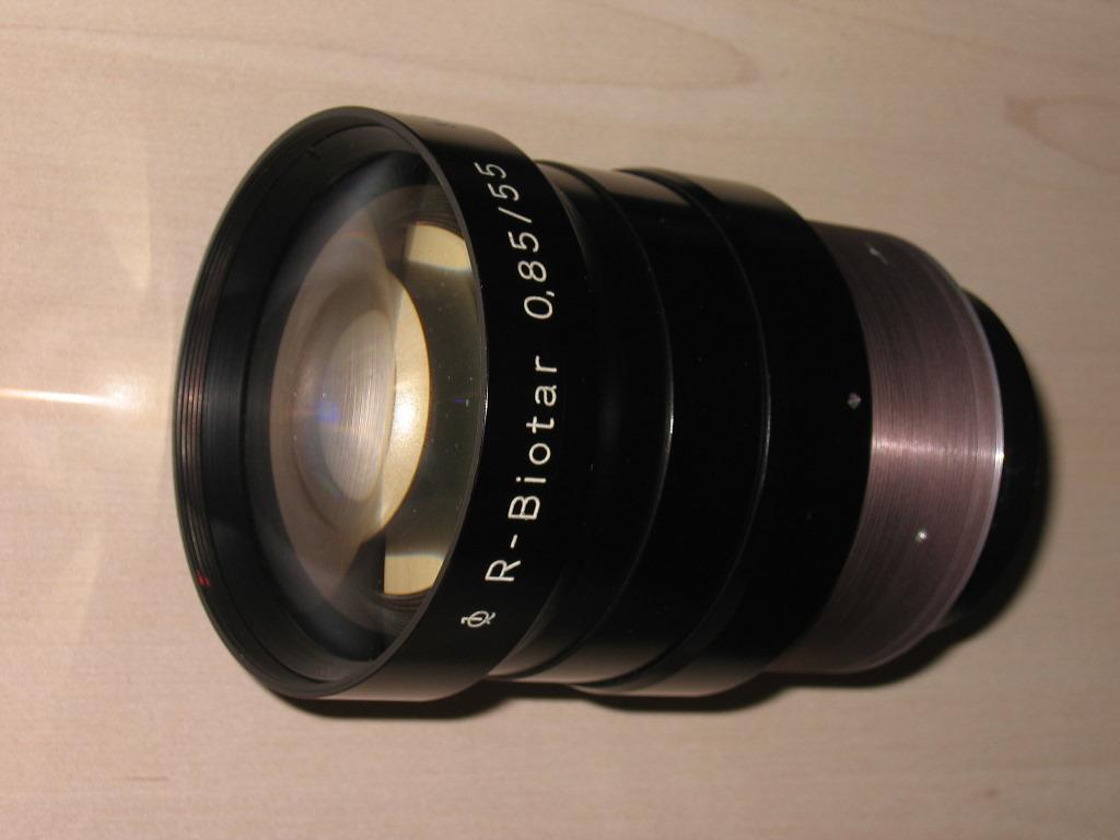

Well, a few others come to mind, the famous Zeiss Jena R-Biotar f0.85/55mm for instance, however its rather short back focal length makes it rather difficult to use on a Nikon, except for macro use. It is not color corrected either.

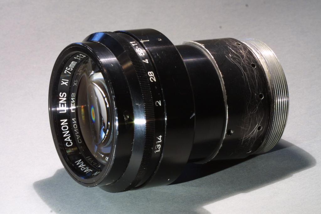

Then there would be the Canon XI 1.3/75mm with built in aperture, also not color corrected but with useful back focal length

Thanks Klaus. I have long wanted to look into the Zeiss Jena, but there are so many variants on Ebay that I was never sure which is the one to get. I don't see any of those online to buy. Can you give me any more info on how to look for one.
Also, very interested if you find the one similar to the CRT Nikkor.
Michael, the R-Biotar 0.85/55mm is an extremely rare and rather expensive lens. I found mine many years years ago at a lens auction house. Few were ever made. You won't be able to find such a lens online anywhere I'm keen enough to predict. I'm not talking about the many cheap and easy to find Xray lenses which also currently flood ebay, stay away from those, I have paid my dues and have a few sitting around unused.
For this other CRT Nikkor look alike f1.2 lens, I will look for it after my return, as I fly away in just a few hours. I know I have it here in my collection somewhere.
