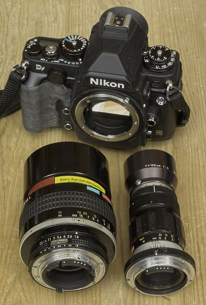

The choice of 105 mm focal length set Nikon apart from other systems in the older days where offerings typically were either 85 mm or 135 mm. The intermediate 105 mm class  aims to cover a lot of ground and really can be considered being a general-purpose lens. The better then that the various 105 Nikkors belong to the some of best lenses ever made by the Mothership.
The 105 mm Nikkor range comprises fast (f/1.8, f/2), medium fast (f/2.5, f/2.8 ), and slow (f/4, f/4.5) lenses. I'll walk through them in turn. Here are the extremes in terms of external appearance: the fast and fat 105/1.8 and the skinny 105/4 Nikkor-T. Both are manual lenses and the tiny f/4 has a preset aperture ring. The 105/4 T quickly disappeared from the product list while the f/1.8 persisted longer, but then reborne as the specialised AF-D 105 mm f/2 DC.
Both of them have CPU for improved handling and metering. The little 'T' has a "G" CPU whilst the f/1.8 being an ordinary AIS design employs an ordinary "P" chip. The f1.8 has the wobbly slide-out hood Nikon designers were fond of in the late '80s and takes 62 mm filters, whilst the 'T' uses equally tiny 34.5 mm filters and have a cute little snap-on hood to match.
