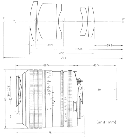

LOL!  You would have to compare it with, say, the venerable 105/2.5!
At least we can be sure that lens really is 105mm:
Ilkka Nissilä
