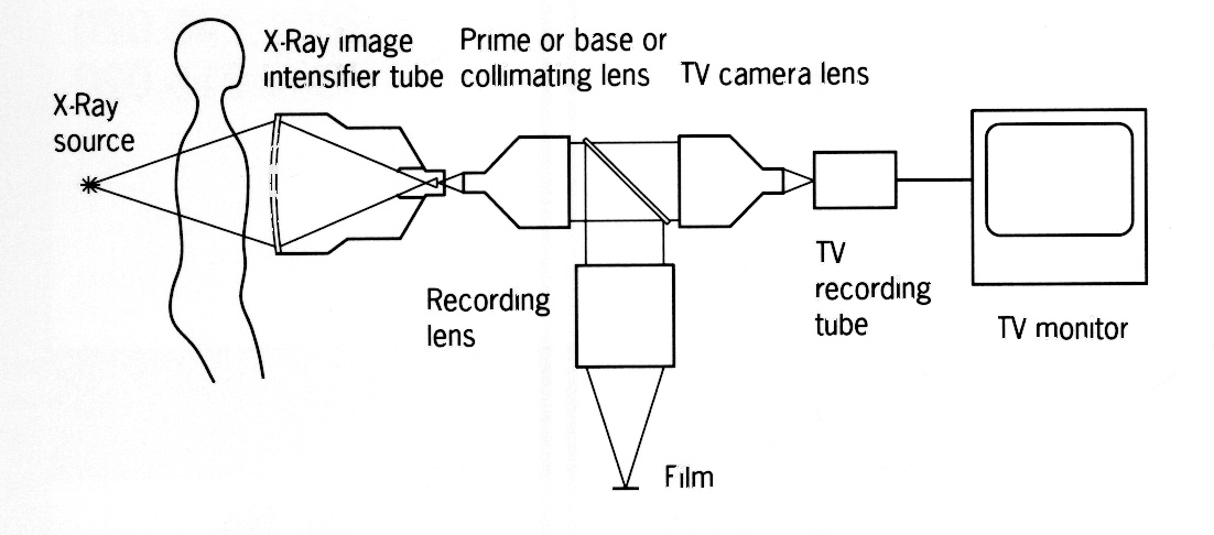

A few diagrams to help people understand why these specialist lenses exist in the first place, and why they are so heavy and rugged.
Basically they help transport the X-ray image into safe viewing positions. The final image can be recorded to [cine] film or TV media.
The first lens is the collimating lens and the second is the recording lens. Due to the construction and placement, there is no conjugate loss of light.
For X-ray screening, limiting the exposure to unhealthy radiation is a primary concern. Hence the use of ultrafast lenses in the imaging system.

Interesting!
Do you have information about the refractive indices of the different elements inside the lens?

Must be very high, if you look at the strong curvature and thickness of the elements Usual speed is f/0.75 or thereabouts.
These X-ray lenses were very expensive, but nothing compared of course to the total price of the X-ray device they were a part of !!
Copied from a post Klaus Schmidt made at forum.mflenses.com, original seen in Sidney E. Ray (2002): Applied photographic Optics. Focal Press, as noted by him.
