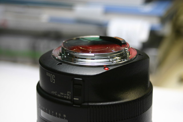

Canon worked around the Rangefinder mechanism of the Canon 7 by using a cut-out on the top of the rear element of the Canon 50/0.95. The same could be done to allow a rear element to clear the electrical contacts of a modern lens.
edited  to add, rear element of the Canon 50/1.0 EOS Mount (not my picture)-
Looks like someone at Canon remembered the 1960 old school methods.

Erik has done this operation several times on various Noct-Nikkors ... Plus on the 50/1.2 AIS.

The 24x36 format works in your favor with hacks like this.
I've put RF cams directly on the rear elements of several SLR lenses to adapt them to Leica mount.  The Canon 50/0.95 is the only lens I know of where they actually cut the glass to make way for the Cam. That lens used a breech-lock bayonet mount for the outer mount, the Canon 7 kept the 39mm Leica thread for the inner mount.
But when you do that you can see it in the out of focus highlights, not so nice, The nice thing about the Noct-Nikkor is that the CPU still sits at the edge of this rear 'aperture' that is painted on the rear of the lens, so OOF highlights are still round.
Not possible with the 50mm f/1 as designed,,,
I have also converted lenses and mounted a cam but the trick is to mount a ring and keep the rangefinder cam well clear off the rear glass

Using a lens designed for the longer register distance of a (D)SLR is beneficial because a cut into the [side of the] rear element is less likely to vignette the exit pupil.
These are with the Canon 50/0.95, wide-open- first shots taken back in 2004. $200 from Ebay, threw it onto my Canon 7- perfect focus across range.
