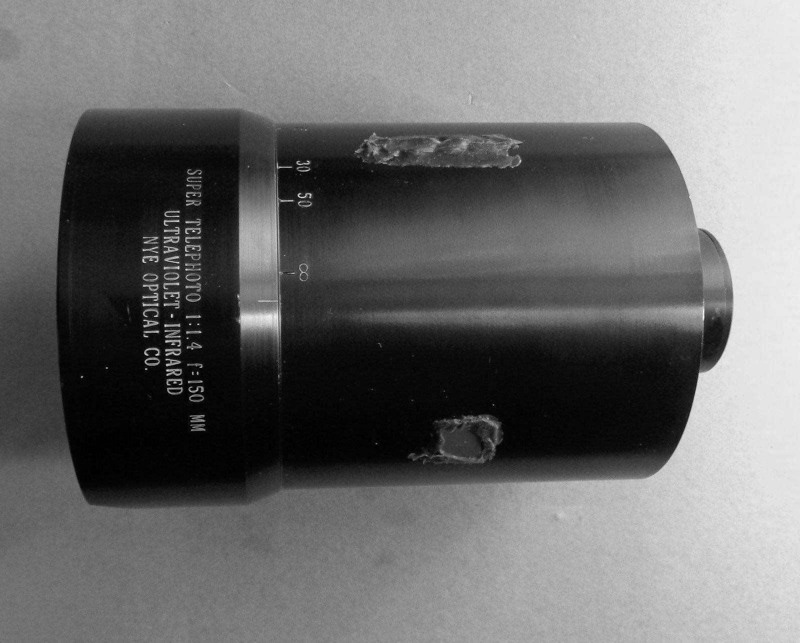

A friend told me about it and was able to buy it. Quite a rare beast actually with Nikon-F mount
and very unusual speed of f1.4 (yes, one point four!!) - and made to work from ultraviolet to IR,
precisely 180nm - 4.500nm. Focus works by moving the primary mirror, beyond infinity to about
10ft - I added a helicoid to get it to focus much closer.
Camera mount is left. Needs a bit TLC, which I will do once I'm back from California.
I have three similar lenses from the same maker, but this one is the most interesting and advanced one.
http://photographyoftheinvisibleworld.blogspot.com/2012/02/uv-vis-ir-lyman-alpha-lenses.html
Too bad the inventor and maker passed away in 2006, his son has sold off all remaining stock since.

There is an important difference between "real quartz" and fused silica - real quatz in optically anisotrope, but fused silica (fused quartz) isn't and also it can be made much more pure, so has much higher transmssion into UV. See https://en.wikipedia.org/wiki/Fused_quartz
So those mirrors are made of fused silica - but if you think about it a bit more, all those mirrors are first surface mirrors and the quartz substrate is just the rear part of it (used because of their very low thermal expansion coefficient), so are irrelevant for transmission. However to protect the first surface mirrors, they are usually overcoated with a very thin layer of fused silica for protection.
The design is a typical catoptic CASSEGRAIN design https://en.wikipedia.org/wiki/Cassegrain_reflector where the seconday, hyperbolic mirror is used to achieve the needed back focal length. (I never really
found out what the exact shape and form of the mirrors are, so it could also be a Ritchey-Chretien etc.)
This one sure looks liker the real thing! What a monster ;)
Not really a monster, just about 1200grams, 150mm front diameter, 200mm lomg (all values approx.).
In terms of performance, what interests most of course is its high speed!

Klaus, yes, I'm aware that the mirror part is on the first surface, and Cassegrain type design uses, unlike the common mirror lenses for the photographic optics, no refractive elements.  That's why I was interested in the use of quartz, which is mentioned in your blog linked in your initial post.  I would suspect that the quartz is more immune to the temperature changes?
Yes, exactly that is the reason. The block of the primary is about 1" or 25mm thick

Werner, thanks for the detailed explanation of the materials.  So, what is the purpose of using quarts for the reflex mirrors in this lens?
  • Posts: 1031
Re: Nye Optical f1.4 / 150mm UV-VIS-IR mirror lens
« Reply #14 on: February 18, 2016, 01:18:43 »
1) to form a very stable substrate, regarding very low thermal expansion, for both mirrors
2) to form a very hard and resistant, yet very transparent (UV-IR) overcoating for thr aluminum first surface mirrors
