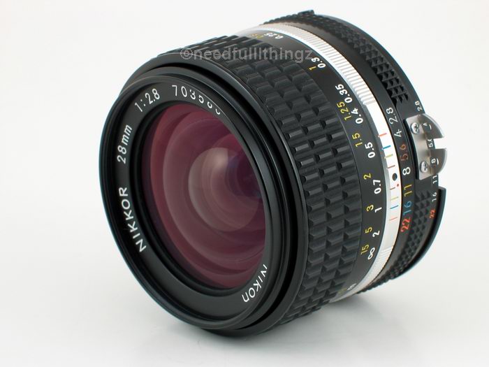

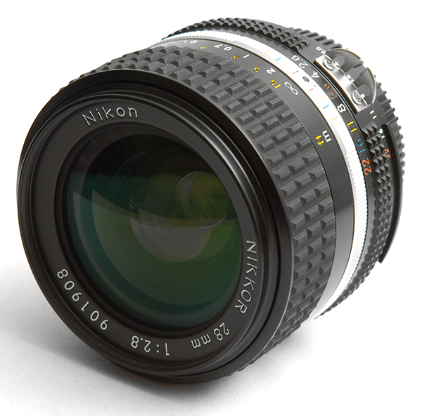

Late AIS 28/2 have the newer Super Integrated Coating (SIC), from about no 825xxx to the end of production. This coating is a light yellow-greenish color. Earlier Nikon Integrated Coatings (NIC) coatings were deep red/green/blue depending on the viewing angle. The AIS 28/2.8 had a similar change, compare the coatings. NIC:
SIC:
I don't know how much difference the newer coating makes, the older coatings were already very good and the 28/2 is known for being resistant to flare.
