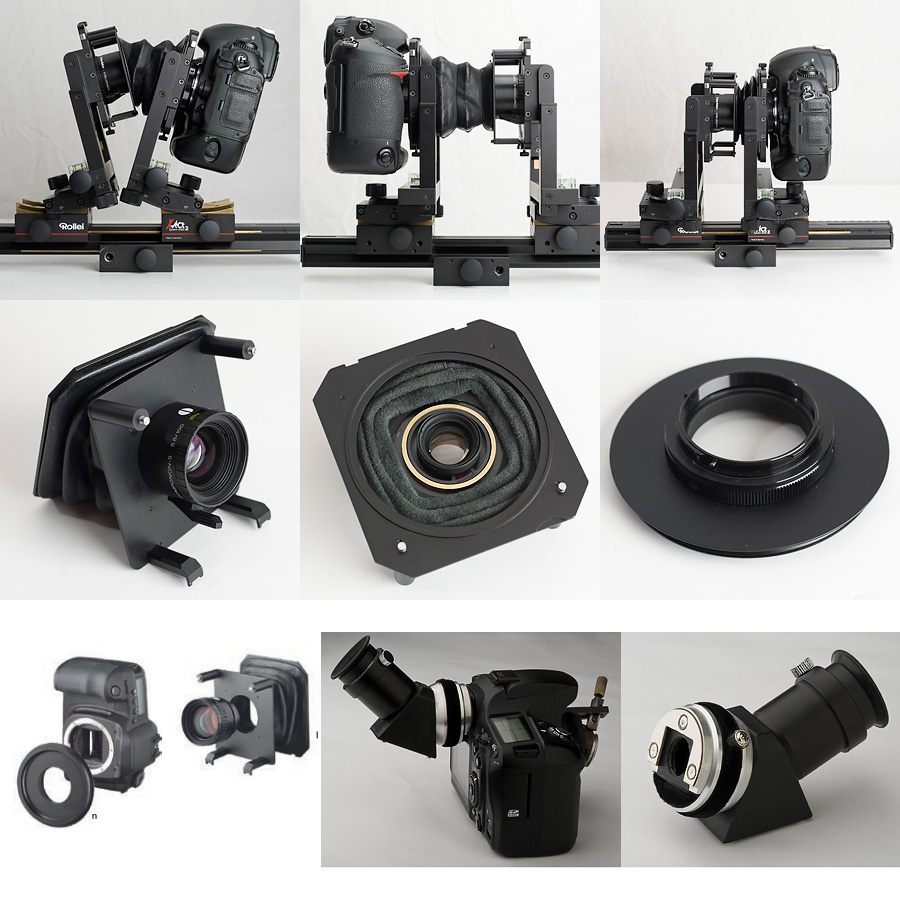

Well, I have committed to the Rollei X-Act2 Bellows System at the suggestion of Klaus Schmitt, who has helped me with my lens concerns for years, in particular in the realm of the industrial lenses. I also have that Kenlock (Spiratone) Bellows Systems en route, and the seller tells me the Nikon D810 works just fine on that system. So, I hope I have one system to use and one system to sell, and that I don't fall in love with and keep both of them That would be so like me.

If it turns out true that the Novolflex BALPRO add ons (camera + lens adapters) seemlessly fit the ROLLEI XACT2 TS bellows system,
then all would been solved, see here: https://www.novoflex.com/en/products/macro-accessories/bellows-systems/adapters-for-castbal-ts/
I have no doubts about ROLLEIFLEX' Eric Hiss words, just need confirmation from Novoflex.
  • Posts: 1023
Talked to NOVOFLEX today and they confirmed that most of their BALPRO adapter plates indeed fit the Rollei XACT2.
No wonder actually, as Novoflex and Rollei coperated on making the XACT2 - they manufactured parts for Rollei.
The will try some out and let me know which does do not fit....
  • Posts: 1023
NOVOFLEX today have tested out and confirmed, that ALL THEIR LENS AND CAMERA ADAPTERS
 for the BALPRO system also fit the Rollei XACT2!

Klaus helped me with my lens, too :) I thank you for it every day. I use Apo El Nikkor 105/5,6, Rollei X-act 2, Pentax camera and 45 degree optical viewfinder x 1,3.   This industrial lens is the best solution for T/S in studio. Nikkor AM ED 120/5,6 has the same construction but .... I prefer AEL.
It is rrb946 - ebey's user Nikon set with recessed bellows. I made compendium from standard bellows.  You need to order from turner a ring m39 with 1-2 mm collar to mount your lens in the middle of recessed bellows.

What is the advantage of the recessed bellows over the bag bellows. And where does one get a recessed bellows for the X-ACT2, which is what I have?
