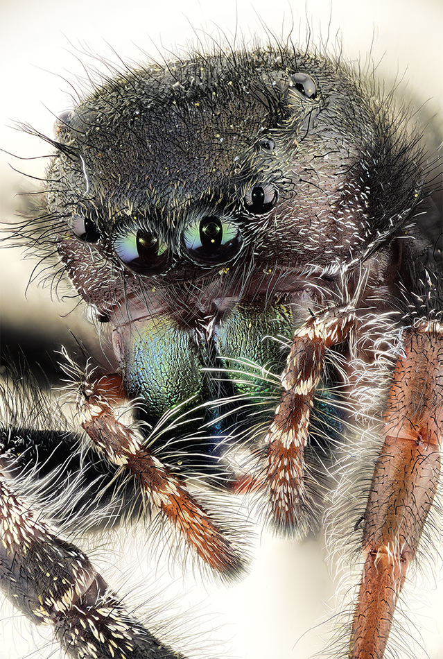

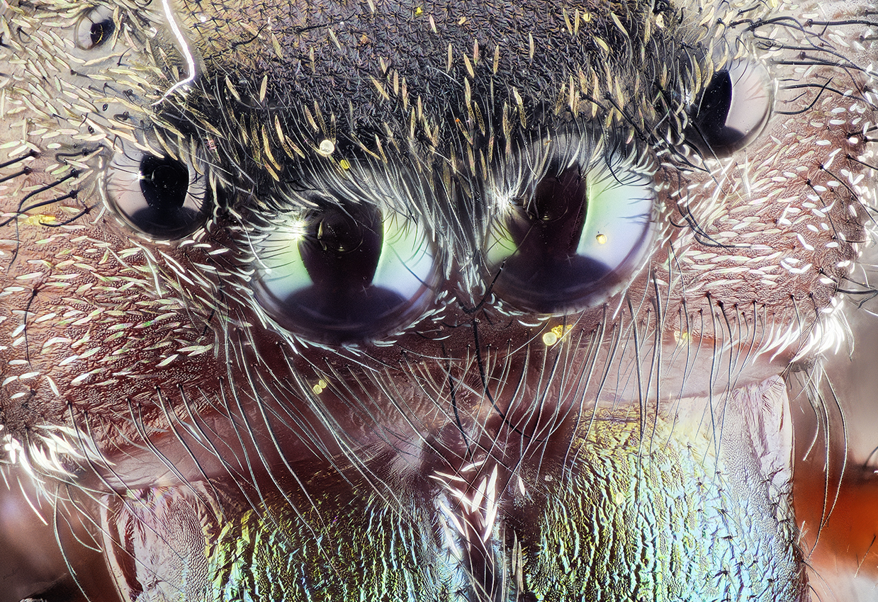

interesting the spider in the image of the first link looks to me to be more around 5x based on my experience... or perhaps a rather large spider :)
for example, this one looks quite similar taken at 5x, so maybe more than 5x in that ad.
and this one at 10x.. so i would say the one in the ad is around 7.5x for that detail..
