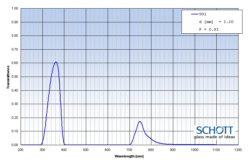

- why not U-330 or a 1mm thick UG-1  instead of the U-360
Here: http://www.ultravioletphotography.com/content/index.php/topic/2459-the-shape-of-things-to-come/, much nicer blue sky for dual band IR
  • Posts: 1304
Re: Nikon 8mm f/2.8 Ai - filter carousel
« Reply #67 on: November 25, 2017, 21:34:34 »
the U-330 looks like it would be better based on the spectrum, greater sensitivity, etc.... and i have used UG-1 extensively.

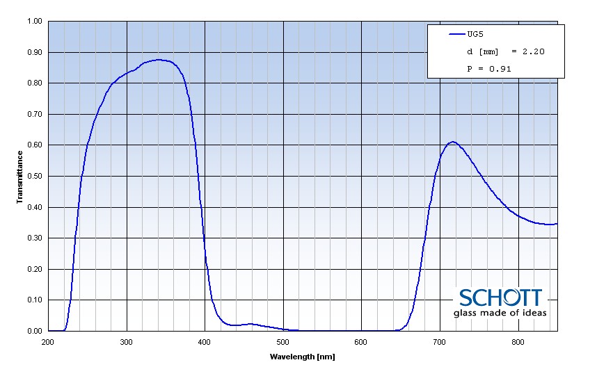

  • Posts: 1033
« Reply #68 on: November 27, 2017, 09:07:15 »
Guess it is less the graphs, but the visible outcome which triggered the decision...
  • Posts: 1304
« Reply #69 on: November 27, 2017, 11:49:40 »
i guess the U-330 is a UG-5
