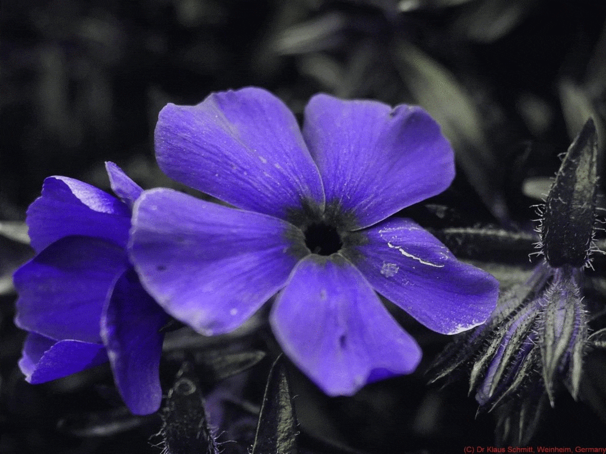

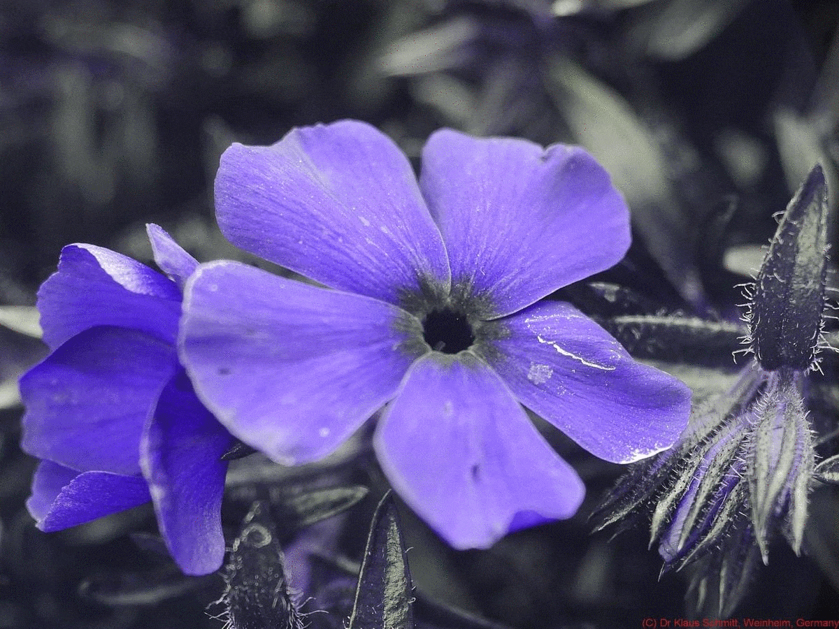

Here today a bit about using the UV-Nikkor 105mm in polarized light, using a PHLOX - Rockfoil flower
and a deep reaching (up to 320nm) circular polarizer in front of a Baader UV filter (320-390nm), so this
is reflecetd UV btw.
Phlox flower in M-mode i.e. non exposure compensated:
Phlox flower in A-mode i.e. exposure compensated:

Interesting. So, basically, the surrounding foliage and stems change more than the flower itself?
  • Posts: 1031
Re: UV Nikkor 105mm and polarizer
« Reply #2 on: April 05, 2020, 20:54:43 »
In this case yes. Just talked to a friend and Professor for insect sensory perception and bees on the
outer rim of their eyes have sensors for polarization he said. So I am looking forward to highly
reflective flowers like the inside of tulips etc. There should be some interesting things to see! Just
all parks here are closed, so no access...

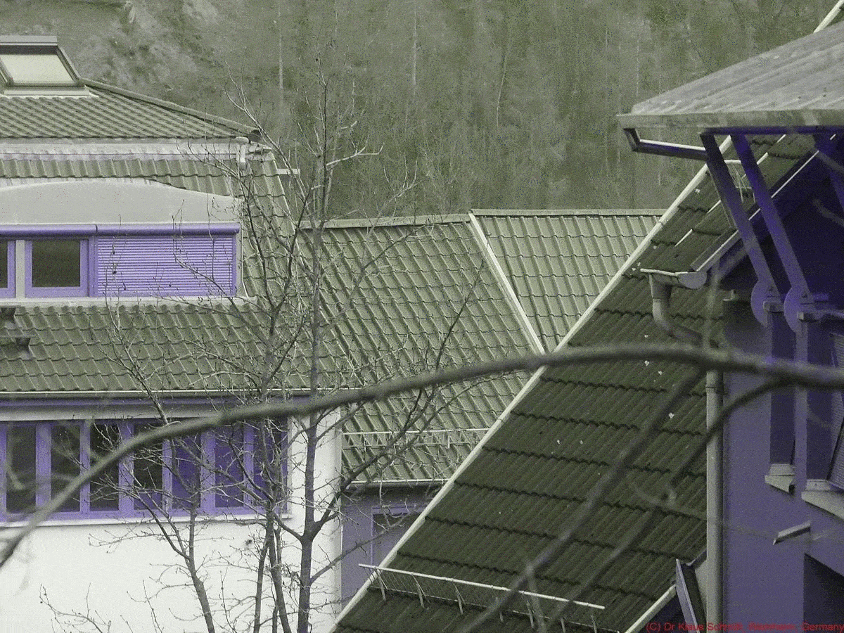

Btw. man-made structures do show quite some polarizing effects...
This was shot using a special Zeiss Jena UV-Polarizer which works down to 300nm (but is this case there is only down to 340-350nm visible)

Regarding the blue flower I like the first image most where the flower reach the darkest blue color.
Possible to post that as a still image?
Here...
MEPER
  • Posts: 1284
« Reply #7 on: April 06, 2020, 14:20:24 »
Thank you!
It is a nice blue color.
