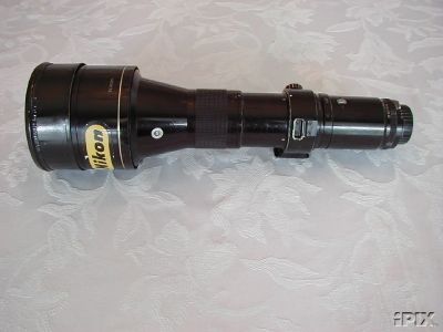

Nikkor-P 135mm f/3.5 Auto It is interesting that Nikon was planning a new version as early as 1963. The new lens would have 5 elements (Nikkor=P = Penta = 5) compared to 4 elements for the existing lens (Nikkor-Q = Quatro = 4). As it turned out, the existing lens remained in production until 1969 when it was replaced by an updated Nikkor-Q, also with 4 elements.
It's interesting that so many prototypes have the diamond pattern rubber grip. In production lenses this was normally used on special lenses such as zooms, reflex, 55mm micro etc, while most lenses continued to use the metal scalloped focus grip until the K/New Nikkor series in 1974.
Reflex-Nikkor 250mm f/8 A interesting little lens, but the not-very-long focal length and slow aperture would have limted its usefulness.
Nikkor-H 300mm f/4.5 Auto I wonder why this lens is so fat? The optics are probably the same as the production model Nikkor-H 300/4.5. Maybe they wanted to make the focus throw longer? The production lens has a relatively focus throw of just 150°, they could easily have made it much longer without changing anything else. The prototype also has a rotating tripod collar, instead of the two fixed points on the production model.
Nikkor-H 400mm f/5.6 Auto This lens is also very fat, and obviously a pre-ED design.
Nikkor 600mm f/5.6 ED This must be a prototype which lead to the AI 600/5.6 IF-ED. A small number of trial pre-AI 400/3.5 and 600/5.6 IF-ED were made for the Montreal Olympics - see https://imaging.nikon.com/history/story/0066/index.htm - but the prototype shown at the Museum has a different design from the trial lenses.

« Reply #25 on: October 30, 2018, 01:23:14 »
Thanks for your input  :o :o :o
i am also wondering why that lens is so fat. there must be some hidden gimmick ::)
  • Posts: 1552
Re: Prototype Nikkors series!
« Reply #26 on: October 30, 2018, 02:34:27 »
VR??  :) :o

The scalloped rings has to be custom cast to fit, a round ring for the rubber grip can easily be made for each prototype. I'm actually surprice that so many of the prototypes has the scalloped rings ;)
The fat versions of the pre production lenses could be due to not wanting to optimise and or down size the internal mechanics for focusing and aperture etc. until the optics where fine tuned.
Thank you for your report Rick and thank you Roland for your detailed comments! Amazing to get behind the scenes info.!
  • Posts: 1552
« Reply #28 on: October 30, 2018, 20:42:50 »
Good point about the rubber grip - they are easier to make for each prototype. I thought the scalloped rings were milled not cast, but it still requires more work...
As for the fat Nikkor-H 300/4.5 (6 elements), the optics of the production lens are almost identical to the older Nikkor-P 300/4.5 (5 elements). The main difference is that the front element of the Nikkor-P is replaced by a doublet in the  Nikkor-H (which is where the extra element comes from). This improves correction for chromatic aberrations which was important as colour films were becoming more common in the late 1960s. The rest of the optical design looks the same, maybe some minor adjustment to spacing, curvature or glass materials. Since the optics are basically the same, they can be housed in a similar barrel, indeed the Nikkor-H 300/4.5 looks identical to the Nikkor-P, it is only a few mm longer due to the thicker doublet, and a little heavier. So it is surprising the prototype is housed in such a different barrel. The other difference is that the prototype appears to have a rotating tripod collar rather than the two fixed points of the production lenses, but that does not explain why the barrel is so fat...
