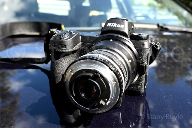

    (*) =  Nikon Z7 with FTZ and a BR-2a macro reverse ring + reversed nikkor 28mm F2.8 E. (picture with my phone)

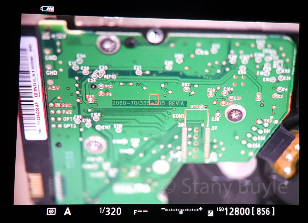

This in the information I see in the viewfinder while using my (MF) micro nikkor 55mm F2.8. (Focus peaking used for AF.)
