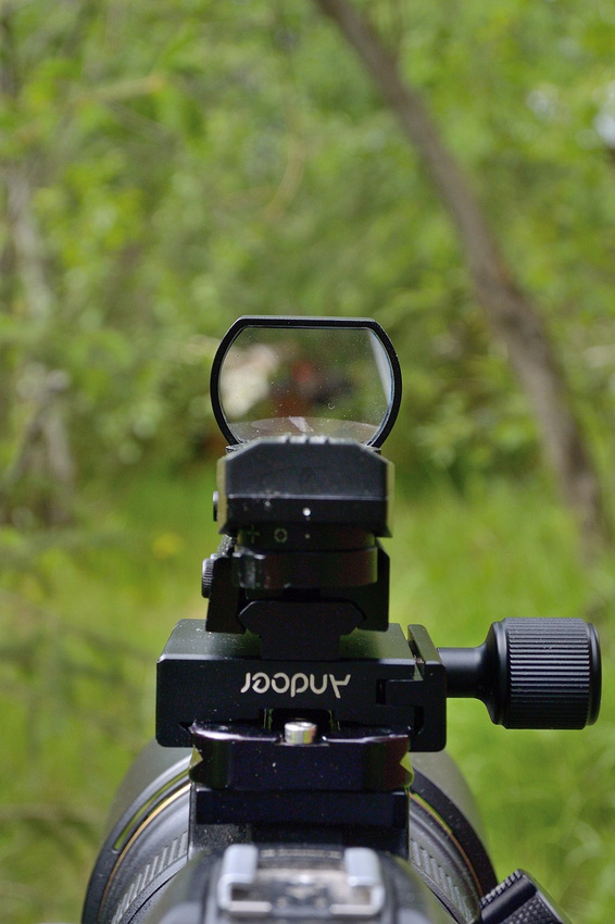

Due to a discussion in this thread, http://nikongear.net/revival/index.php/topic,7484.msg121515.html#msg121515, an idea surfaced to use a clamp to mount my red dot to the usually unused lens plate on the collar of my 300mm PF.  The 50mm clamp and a 2" long rail off ebay for a total of $12.40 shipped arrived the other day and had to be tried out. The clamp screw has a nice dampened feeling, but as many of the Amazon reviews suggested, I would have replaced the mounting screw with a better hex screw if I were to put more weight on the clamp. A hole was drilled in the rail for the mounting screw, and I expanded one of the keys of the clamp to fit with a key on the rail. As the keying did not get as precise as I had hoped, I simply applied a couple of drops of epoxy before permanently screwing it together, and immediately went outside to fine adjust the horizontal angle before the epoxy could set. Here is the resulting rig; during astrophotography I usually mount the camera to the tracker via the camera plate anyway due to the light weight of the 300mm PF as it gives better balance when aiming high so I do not need the lens collar for that purpose:

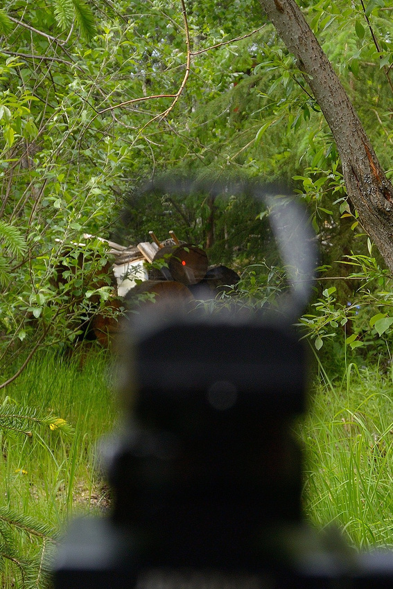

After the epoxy set a final adjustment was made with the horizontal/vertical correction screws on the sight, and I used reindeer at the Large Animal Research Station for handheld target practice, here aiming near the neck. This is a crop of slightly more than 1/3 of the center of the frame. It is lucky for the eartagged reindeer that I had a camera and not a firearm so it did not end up as reindeer steak:

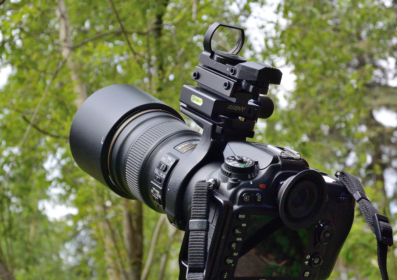

Overall I would say it is a success. While there would be parallax deviations with close subjects, this is of course not a problem with night sky targets. It will be a few months before I can test it on a dark sky though, but this should eliminate the need to calibrate the open sight each time. The position of the sight forward on the lens is also more comfortable to use.
