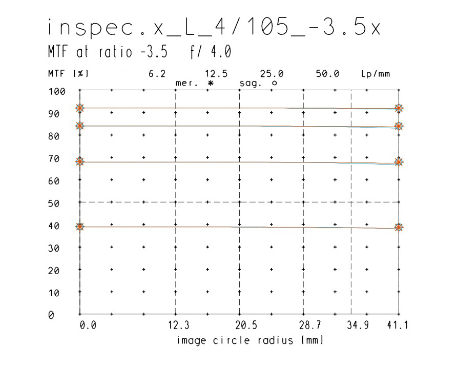

Sorry, but I don't know what 105IXL3p5 is.
The Qioptic LINOS Inspec.x L 4/105 3.5X lens most likely...
Unbelievable MTF actually ...
Data sheet is here: https://www.qioptiq-shop.com/out/Graphics/en/00121307_0.pdf
Sorry for my shorthand. As Klaus says it is the Linos/Rodenstock 105mm f4 Inspec.x L 3.5x line scan lens.
Those MTFs, like all Qioptic/Linos/Rodenstock MTFs, are simulated, not measured.
