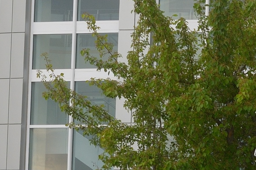

At the time I also performed a test towards a local building with dark clouds behind, and the lower contrast (and warmer color) of the 55 f/2.8 was also noticeable there.*
What I'm seeing is the lower 55/2.8 crop is lighter over all and not that the shadow areas are lighter as I'd expect if there a difference in flare. I'll guess that the 55/2.8 received more exposure than the 55/3.5.
To remove any doubt I created two new crops where I tried both to compensate for differences in color balance and exposure (references on the grey panels of the building). I also made the crops exactly the same. If you are still not convinced, download the files and flip between them. The difference is very clear.
100% crop  55mm f/3.5 AI at f/5.6
100% crop  55mm f/2.8 AIS at f/5.6

Here are two quick shots with no artistic merit, the first taken with an AI 55/3.5 micro, the second with an AIS 55/2.8 micro, both at f/8, no filters used, camera set to aperture priority.
I used stop-down metering to ensure consistent exposures. I partially mounted the lens, so the aperture stop-down lever and the AI coupling tab were dis-engaged - the lens stops down to the aperture setting and the camera meters as-is.. Any possible discrepancy between the setting on the aperture ring (which was f/8) and the actual aperture opening (which might be f/7.2 or f/8.5 or ...), is compensated by the camera meter which adjusts the shutter speed to ensure the exposure is identical between the two. The aim here is to purely assess the lens performance, not the stop-down mechanism :). The color and contrast look pretty much identical to me:

Thanks Roland, I agree; not much difference in your images if opened in separate tabs and flipping between them. (It is funny how the brain gets tricked to think that the top image is slightly darker when viewed on the original page). So either there is the difference with the SIC coating on your f/2.8 version or there is an issue with the lens I tried out. I might try to get back to my coworker and see if he still has the lens for closer inspection. It had an issue with a somewhat slow diaphragm as I recall, but worked fine in stop down mode in live view.
A third possibility is differences in the vintage (and coatings) of the 55mm f/3.5 AI versions, which seems less likely. What series does the copy you used belong to?
A forth possibility is that the difference only shows up when focused near infinity (the hypothesis would be that different positions of CRC elements cause different flare characteristics). I had a hard time seeing any difference in contrast and resolution at close range in the copies here, but the comparison was difficult as I was not careful enough and the focus plane ended up at slightly different locations.
Your brain is not being "tricked". When viewing a screen I am sure you will have noticed changes in brightness when viewing from the side at extreme angles. Screens seem to be designed to permit wide viewing angles from side to side, but not so much up and down. You will see how the brightness changes you tilt your screen up and down...
The 55/2.8 micro that I tested was the one with NIC coating. SIC is an improved multi-layer coating but NIC was already very good, I am not sure how much difference it really makes (maybe something else to test one day).
If the lens you tried had a slow diaphragm, it probably had oil on the aperture blades (a common problem with the AIS 55 micro). This will cause exposure errors, especially at fast shutter speeds and small apertures. It's possible some oil also evaporated and deposited on the lens, which could explain the lower contract. Did the lens have a filter attached?
The AI 55/3.5 I used was relatively late, serial number 101xxxxx, but I don't think coatings changed much from at least 1977 when AI lenses were introduced, all the way through the AI-S and AF series up to about year 2000 when SIC was introduced. So I don't think the AI version somehow had better or more effective coatings than the AI-S.
I could repeat the tests at infinity or other distances, but I strongly suspect my results will be similar.
Thanks again, Roland. Your 55mm f/3.5 is also of the latest series, so agree that it is likely similar to my copies. It would be interesting with an infinity test too. I agree that oily residues could have been an undetected issue on the f/2.8 version I tested. No filter was attached, of course. My coworker still has his lens; he had it serviced in the mean time and will bring it in to work later in the week so that I can get to examine it again.
BTW, I think the effect of different apparent brightness is at least partly due to a physiological phenomenon called lateral inhibition, https://en.wikipedia.org/wiki/Lateral_inhibition, check visual inhibition down on the page for informaton. (I have an IPS screen with very wide viewing angles). Technically it occurs already in the neural network at the retinal levels but there could also be interpretation at higher levels contributing in this case. It is a little like a sharpening effect or rather a clarity slider. It usually occurs along contrasting edges, but I think that when the the bright upper part of the lower image is compared to the close by darker lower part of the upper image it might appear brighter.
