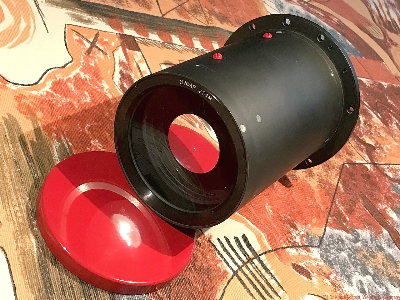

Was waiting and searching over 10 years for such a lens until I finally found it...

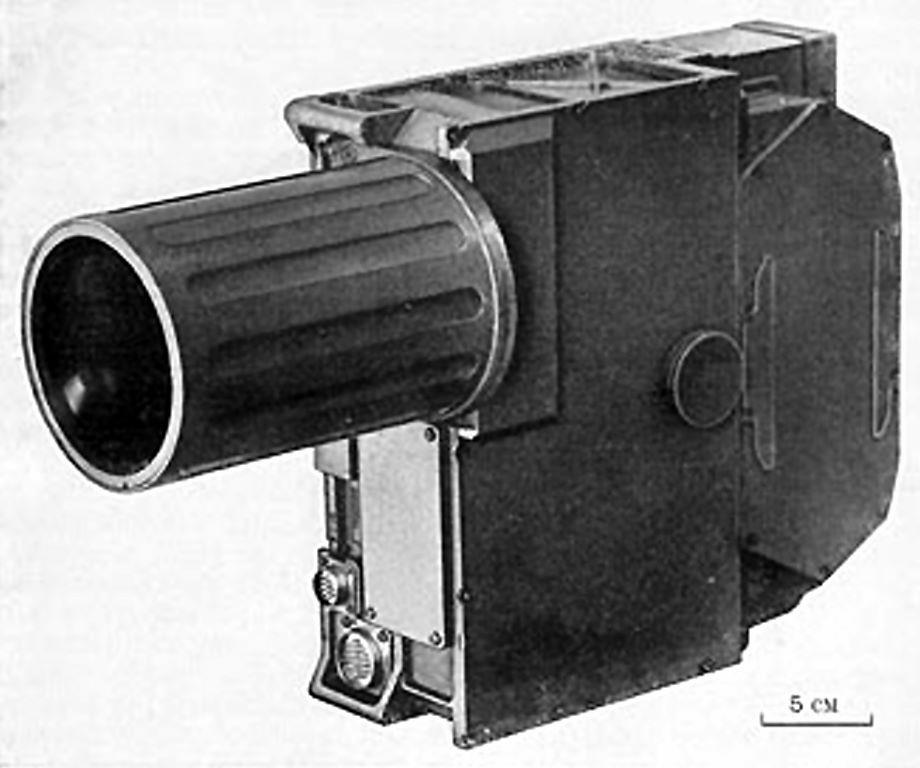

It was made for the Soviet MARS 2-5 missions to planet Mars using a very elaborate camera

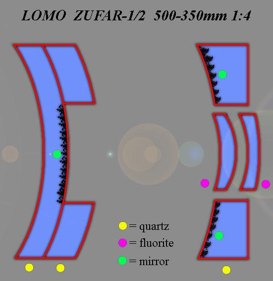

with a 4/350mm catadioptric quartz fluorite lens [lens drawing made exclusively for me by my dear friend Marco Cavina]:
which delivered very sharp images of the Mars surface:
And here is the lens in unused condition, a spare one of the very few ever made, that did not make it to Mars:
It was designed and made of only Quartz and Fluorite to be able to work in UV and visible light, 300-700nm without focus shift.
So it actually is an APO 350mm catadioptric lens. Its whole useful wavelength range is 230-700nm.
Data of this lens, as well as its normal quartz fluorite sister lenses for the Mars mission are here on my site:
http://www.macrolenses.de/ml_detail_sl.php?ObjektiveNr=323
More may be read about it here on my Blog:
http://photographyoftheinvisibleworld.blogspot.de/2018/02/zufar-4350mm-quartz-fluorite.html
About mounting this lens: I have measured the back focal length (BFL) to be at infinity about 70-75mm, so there is plenty of room to even adapt it
to Nikon with its long register length of 46.5mm, but I will use it on my mft multispectral cameras most likely, which allow me to have approx. 50-55mm
for a focus mount and also a rear slide in filter holder, most likely the DEO-TECH OWL adapter which I have already here.

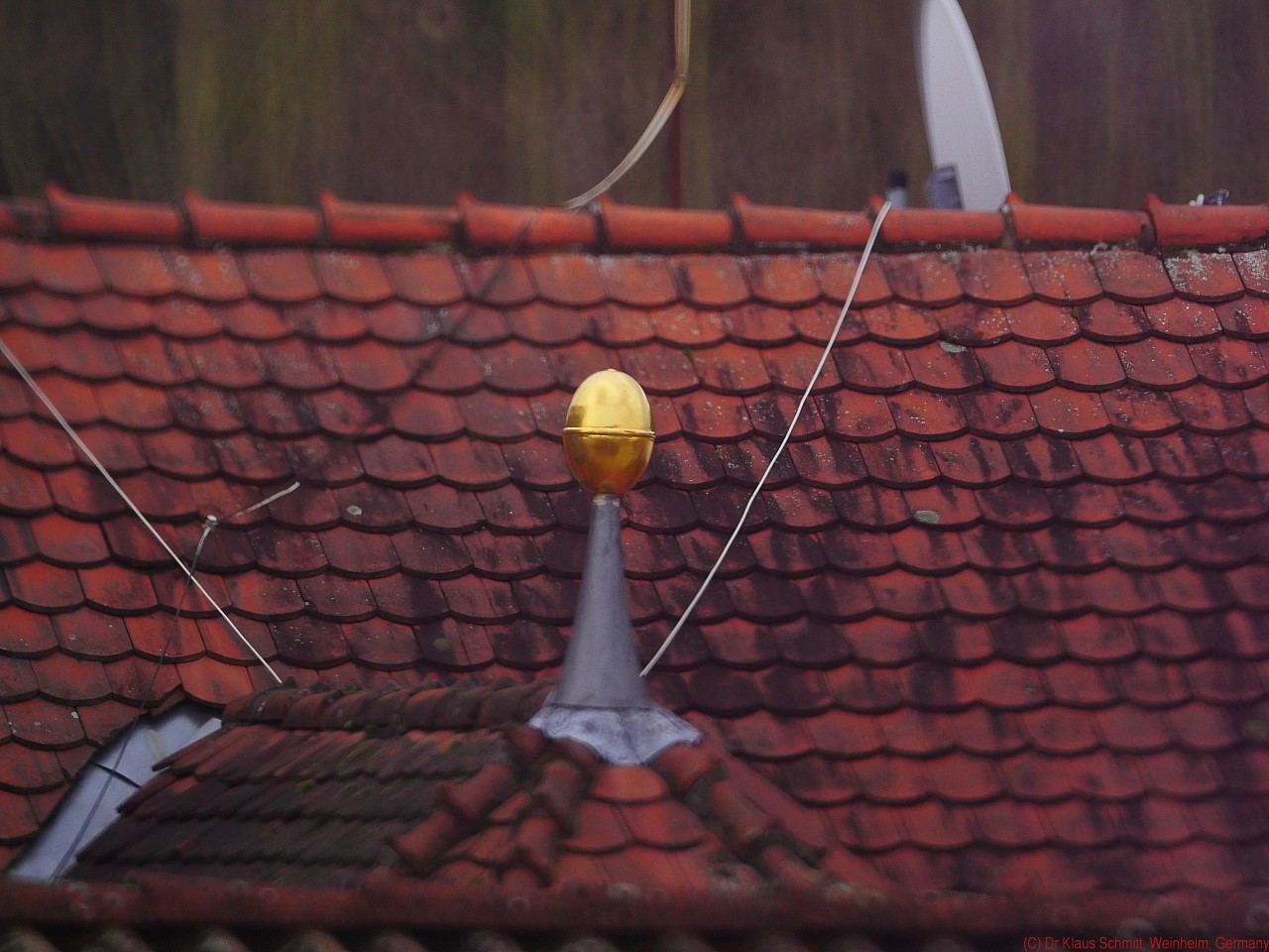

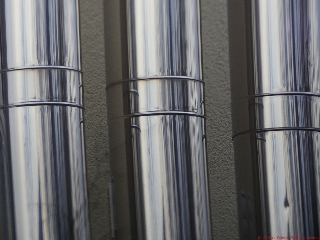

Here a few freelensed test shots on a gloomy day...
About 100m away:
About 15m away:

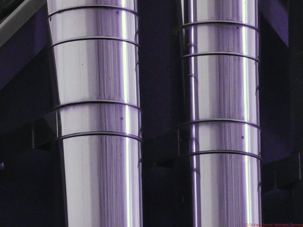

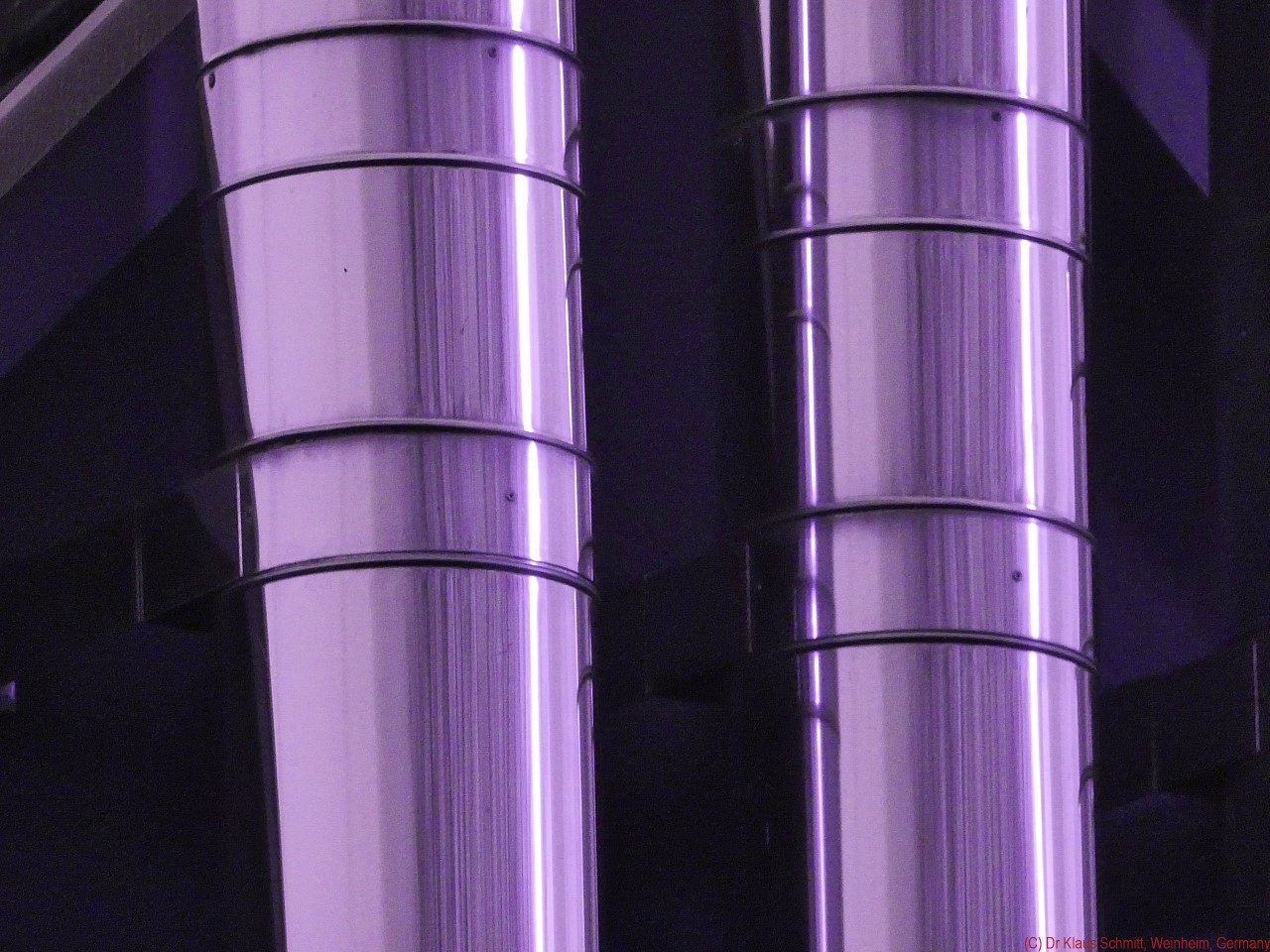

Well, here the 1st reflected UV image I took with it...handheld freelensing, high ISO:
whitebalanced it looks like this:
  • Posts: 12546
Looks like impeccable...
  • Posts: 1005
Pretty happy with it so far, considering that I don't even have a mount for it yet...

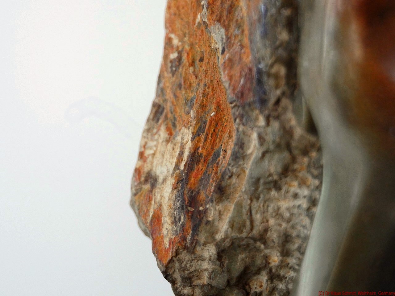

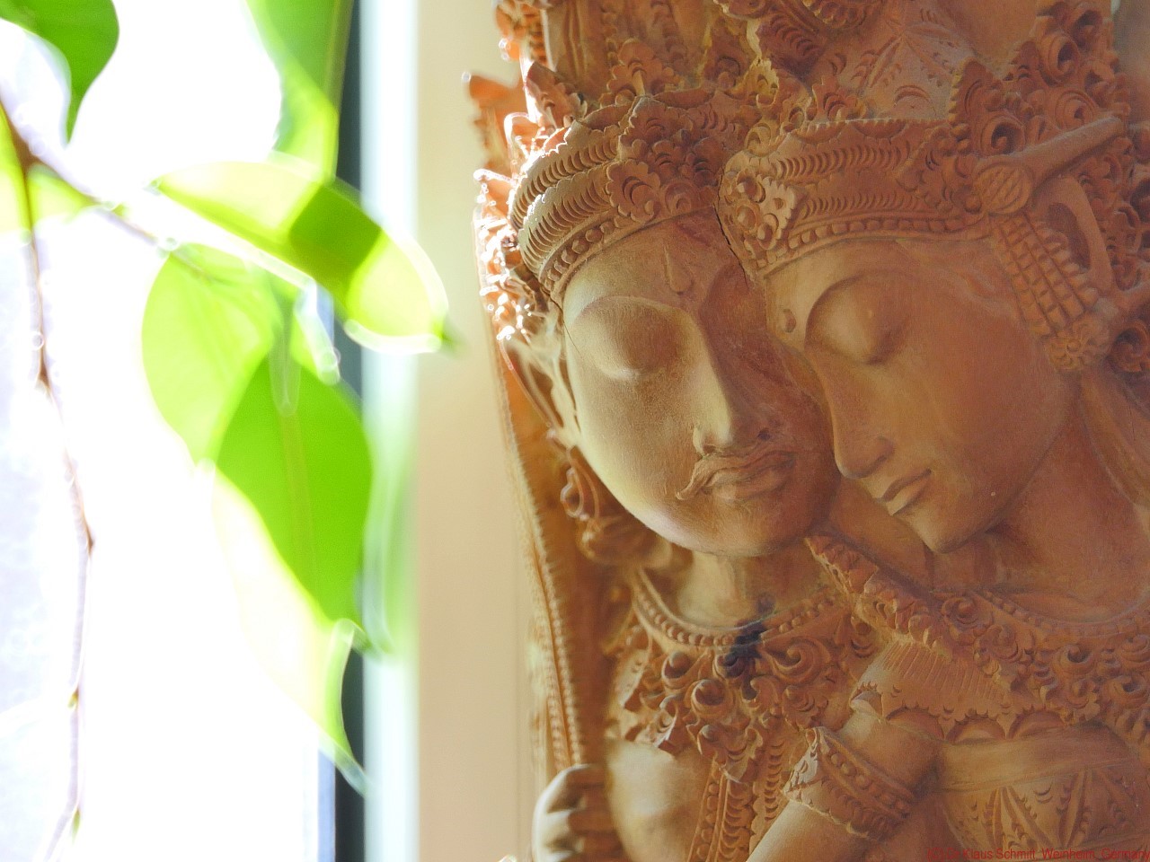

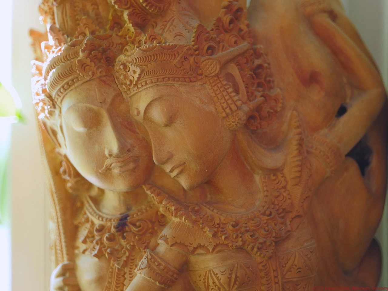

Trying to see how well it does closeups...
Here a Balinese Sandlewood carving shot against the light (no hood used):
And here a detail of a Shona stone carving (very slanted angle to show DOF):
Both about 3 meters away

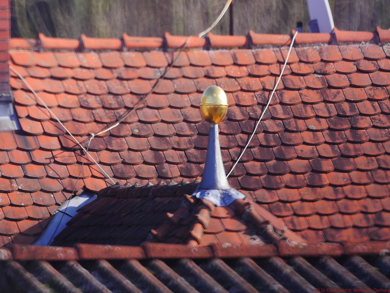

And here a quite better focused image of my standard target, that golden ball at sunny weather:
