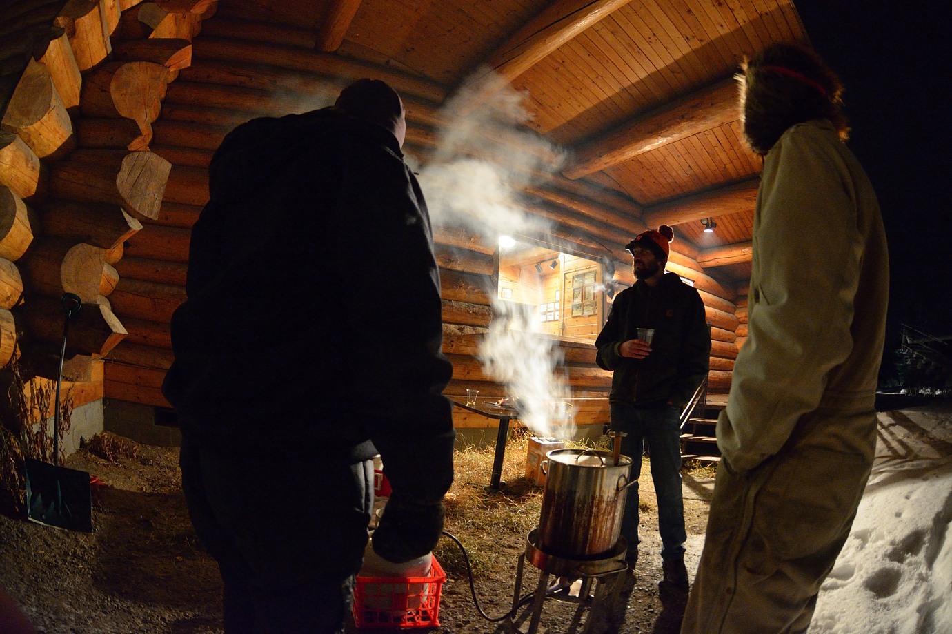

For best results for night shots like the one shown above the obvious answer is to use a tripod. You can then use low ISO and get excellent dynamic range and even stop the lens down a little improve the performance. However the D7100 can easily perform handheld shots in low light. 1/60 sec with a 35mm lens should be feasible, as long as one concentrate on the landholding and are not be in a hurry. A full frame body would gain a stop or a little more with a newer sensor, but the presented capture above would still have been be a little blurry with ISO 10000, and you would not have been able to stop the motion of the car zipping by. For hand holding in low light it helps to use a wider lens though. The image below was captured with my D7100 at ISO 4000 and handheld at 1/13 s, so although I "cheated" by using a fisheye, the shutter speed in relation to focal length should be lower than in your frame above with respect to the central portion of the frame.
Turkey Deep Frying
D7100, f/3.5 @ 10.5 mm, 1/13, ISO 4000
When a tripod is not available, one can use whatever means possible to brace the camera.
Below is my modest AW1 with its 2.7x crop sensor, that still gives usable results for night shots, braced with clumps of snow as the tripod of course was busy. A full frame sensor would have required to stop the lens down much more to get adequate depth of field.
NIKON 1 AW1, f/5.6 @ 10 mm, 30s, ISO 800
