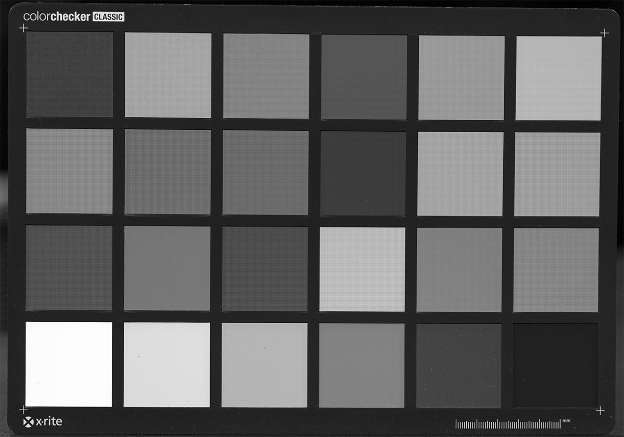

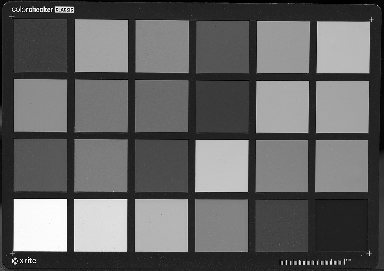

An initial comparison.. processed identically in DarkTable, some level/contrast enhancement, demosiac turned off, matrix exposure, identical lighting D55
Nikon D800M ,Zeiss Apo Sonnar T* f/2 135mm
1s f/5.6 at 135.0mm iso100
Nikon D800 Stock ,Zeiss Apo Sonnar T* f/2 135mm
0.62s f/5.6 at 135.0mm iso160

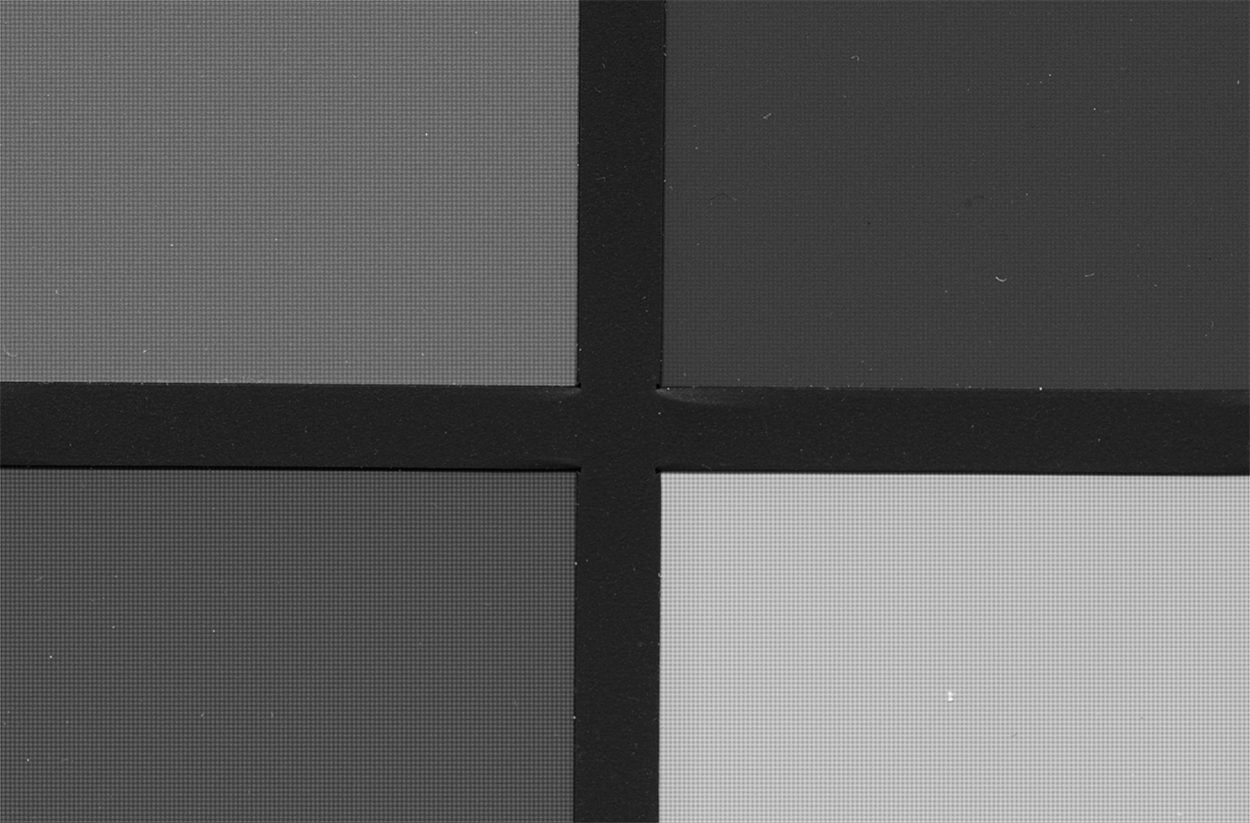

100% crop center

Bob, I observe very fine grid patterns on the patches of color checker (100% crop?) shot with the stock D800.  Are they caused by the demosaic turned off?

Personally, I can't see any grid pattern in the color shot, but I certainly do with the other shots.

Kuri, I was referring to the second last B&W image where you should be able to see the grid pattern clearly.

Akira, Oh yes, I agree, the black and white shots show the pattern.

But the same crop by D800M doesn't show the grid.  That's why I suspected that the demosaic turned off.
yes.. demosaic turned off..  the reason you see this is that those colors with greater grid pattern have a purer red or blue channel.. since there is 25% red, 25% blue and 50% green, the colors with more green components will have more contributing pixels..   consequently more resolution 36mpx = 9mpx red + 9mpx blue + 18mpx green
the monochrome conversion sensor has the full 36mpx resolution

But resolution is determined by luminance, even in colour images, because "the human brain enables rather coarse color information to be added to fine spatial information and integrates the two almost seamlessly". (http://micro.magnet.fsu.edu/primer/digitalimaging/cmosimagesensors.html).  It can do that because the channels are not pure, however pure the colours on the card are, because there is a lot of spectral overlap in the filter transmission. The result is that most of the spatial data from any colour is in all the channels when you have a Bayer array (ie, the MaxMax site's [https://maxmax.com/b&w_conversion.htm] statement that "suppose the target is illuminated with a blue light?  You would only get 1/4 of the pixels possibly seeing the blue light" is badly wrong).  The blue filter has the least overlap, so spatial resolution is lower for monochrome blue areas - so in your images the texture in the Colorchecker squares should be least evident in squares 3, 13, and above all 8, and it isn't.
One thing that bothers me is that the lightness of the patches of the Colorchecker are as they should be in the native images but they are not in the Bayer-less images. For example, square 2 should be the same as square 21 and in the native images it is, but in the Bayer-less images it isn't; another example is 17 and 18, which should be the same.
