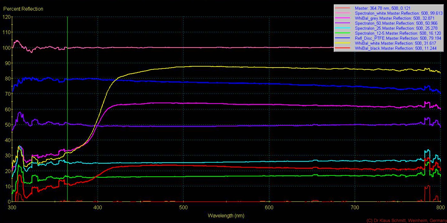

I measured the whibal once and was not really happy with it, maybe this is the culprit? Whibal lacks some blue and has a little bit too much green (yellow line)
I only use Spectralon or white PTFE since then w/o issues...

Seems to be the standard here; Best white balance target is white PTFE
Bjørn also recommended this for shooting in UV.
