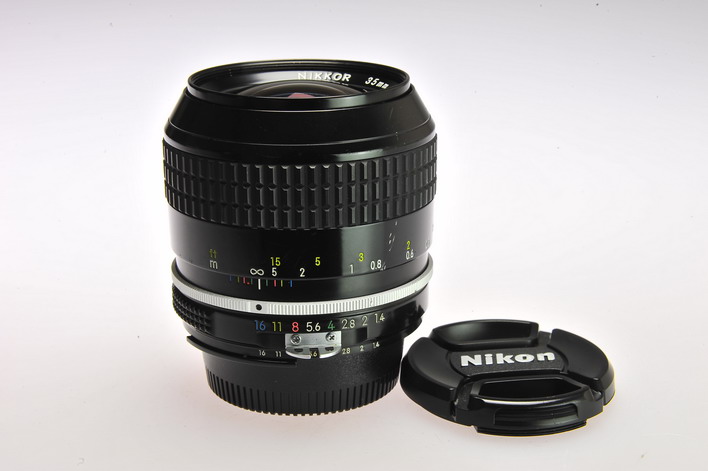

I have a 35/1.4 AI which is now almost completely stuck and almost impossible to focus. I'm tempted to clean it myself. I have not found anything relevant on internet, except a video opening it but not touching the helicoids. I also have, of course, read Richard's advices.
Has any of you already cleaned and regreased the helicoids on that lens? Any specific advice?

which 35/1.4 is it? this one? :o :o :o
if it is, send it to me. I will fix it for the blog...

Yes, this one
