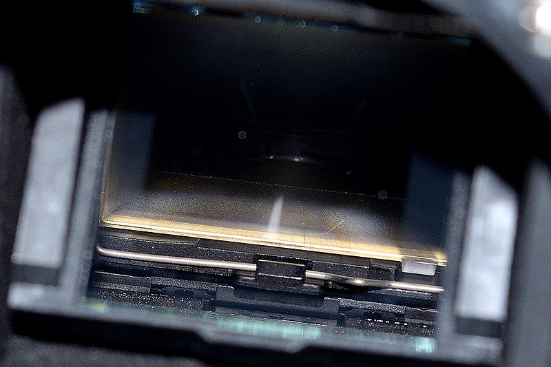

I just thought it is worth mentioning that the images for the D7100 install on focusingscreen.com's web site are incorrect. They assume D7100 and D7000 have  the same layout. Inspection of my D7100 (below) shows that it is similar to D300, which is correctly used as example for the D7100 install at the Katzeye site. On the images showing  D7000 in Focusingscreen's instructions, and D90 on Katzeye's site, the retaining wire has to be pulled towards the mount to be released, while on the D7100 (and D300) it is pushed towards the screen for release. The retaining wire has a bump to make it easier to release it.
The D7100 focusing screen retaining wire and catch (reflected in the mirror):
