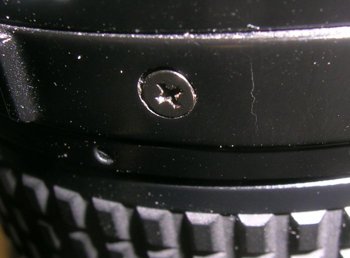

Damn, my 28/1.4D has developed the dreaded fracture in the A/M ring. It is already 90 % broken. I wonder whether there's still spare parts?  :(

Apparently all lenses with this particular A/M selector ring are bound to end up with a cracked ring. The crack can develop so the lens splits into two halves. Experiencing such mishap is no fun. I have had it with 105 DC and the 200/4 AF Micro.
Whether spare parts for repair exist is an open question, that only your Nikon repair facility can answer. Nikon could supply parts for my 200 Micro but not for the 105 DC.  Any repair is going to be costly, though.
The easiest and by far cheapest solution is to forgo any AF operation in the future. No big loss as its AF is noisy and slow. To prevent the ring from splitting completely, which tends to happen at the most awkward moments, I recommend sealing the ring in place with judicious amounts of sticky 'tar' tape, the kind used for ice hockey sticks and bicycle handlebars. This tape will literally weld itself over time so keeping the lens safely together. I have done that measure on every lens in my possession having the tendency for A/M cracking.

Some of the affected lenses do fall apart, like my 105 DC. Others expose a very ugly opening straight into the internals of the lens, through which dirt or stray light may enter.
The design of the A/M was introduced in the early stage of the AF era and Nikon, for some inscrutable reason, probably thought the selector would be set to 'A' all the time ? Nobody really knows, though. And for reasons explained below, it really doesn't matter whether the ring was used.
The crack comes as a result of material fatigue, because the ring on some models simply is a little on the wide side (designated play to make altering the setting easier?), and there is only a single screw that keeps it in position. Over time this leads to the infamous crack. In fact, the A/M ring will develop a fracture even in the case it never has been used, that happened with my 200 AFS Micro after 11 years of non-use.
Some time during the early 00's, the design was altered and never seen on newer models.

Would it be effective to epoxy a strip of stainless steel across the screw so plastic fatigue at or near the screw does not cause a failure. I'm thinking a small hole might be drilled in the stainless steel strip and a dot of mold release placed on the head of the screw so it might be accessed if need be. I believe I own three of the lenses with this style A/M control. In particular I don't want to loose my AF 70-180/4.5-5.6D ED Micro-Nikkor.

Yes, a support strip or even better a ring could keep the plastic-ring together in one piece..
The ring doesn't hold 'two half's' together,,,
