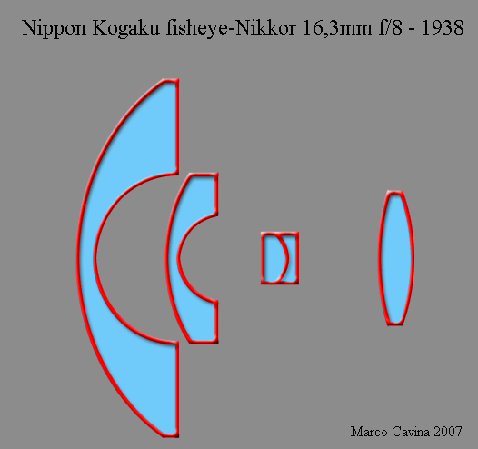

The lens in the package was a 16.3mm f8 fisheye with initial development by Nippon Kogaku going as far back as 1938.

Tatsuhiko Arakawa (author of Nikon Story) says that, around the start of WWII, the Japanese Navy submitted a request to Nippon Kogaku to design and supply a camera of this type. Apparently it took Nippon Kogaku quite some time to come up with a solution with the final design and production drawings having been completed around Aril 1938.
This was to be Nippon Kogaku's first attempt at designing and manufacturing a fish-eye lens.
Tatsuhiko has seen the drawings of this early camera from 1938 and confirms that the early design is very similar to the 1960 design in specifications such as F value and the number of elements. He suggests that the early design was carried over into the 1960 Sky Camera.
Due to a high amount of chromatic aberration, only B&W film could be used with the Sky Camera.
On a side note; it's thought that design of the Fisheye-NIKKOR 8mm f/8 was based on the 16.3mm f/8. Major improvements in lens design and manufacture over the years leading up to the 8mm saw a significant amount of chromatic aberration being removed which would now allow the use of colour film.

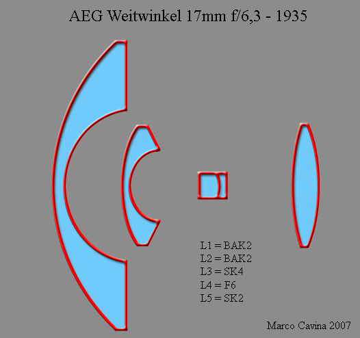

My good friend Marco Cavina has written extensively about them (beware, looong articles with many pics)...if your Italian is a bit rusty, use google translate...
http://www.marcocavina.com/articoli_fotografici/Nikkor_fisheye_story/00_pag.htm
Here about what the Germans have done before:
http://www.marcocavina.com/articoli_fotografici/CZJ_Perimetar_Sphaerogon_Pleon/00_pag.htm
and here a comparison, showing how much engineers can "learn" from each other (was that PC enough? :LOL: )
http://www.marcocavina.com/articoli_fotografici/AEG_fisheye_1935/00_pag.htm

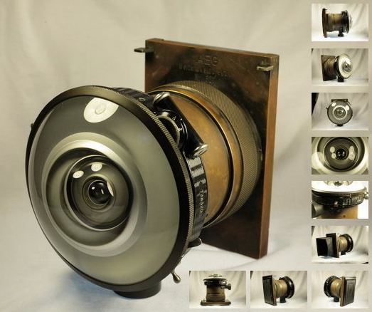

After studying the info he has provided; I'm wondering if the original Japanese article may be incorrect when it states that the Nikkor was based on a Zeiss design.
Marco feels that it is an AEG design that Nikkor used rather than a Zeiss.
Looking at the AEG, it certainly looks more like the early Nikkor.
Marco suggests that the AEG is "the mother of all modern fisheye lenses".
I may have to amend my information.

Yep, I thought you may like the results of the extensive research Marco has done (and a bit me, as I had re-discovered the ZEISS files from the liberated Zeiss lens collections which were brought to the US after WWII, which I subsequently donated to the Zeiss Historical Society).
A friend of mine had recently found one of the few remaining AEG Wolkencameras ("cloud cameras") and Marco also contributed to that research:
http://www.aeg-wolkenkamera.de/index-eng.htm
The lens was sold off at a Westlicht auction later...
