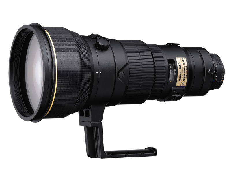

I must say that I am confused.
Silent Wave Motors were introduced with the AF-S Series and "AF-D" means screwdriver AF ?????

This one is both AF-S and D, but not G. (Image linked from Roland's Nikon Pages)
If I remember correctly, the D simply means that there is a sensor in the lens that feeds the focus setting back to the camera for better metering and autofocus. Presumably most G lenses have such a sensor, but the D designation was dropped later on.

« Reply #53 on: January 31, 2020, 14:10:36 »
D lenses implement (very coarse) encoding of distance; I doubt it can be used for much help in focusing. It's useful for direct flash calculations. I recall that it was used to distinguish between close-up and normal distance subjects as different algorithms were used in matrix metering for those two, but I don't really know if the current algorithms make such a distinction. Nikon do talk about 3D matrix metering when it is enhanced with the distance information.
D is unrelated to autofocus.

« Reply #55 on: January 31, 2020, 17:36:52 »
Thanks, I wasn‘t sure about the AF, but thought that for AF-S and lenses without motor the D signal is the only way for the camera to know the state of the cams/gears, which could potentially help in supplying the correct voltage to the motor. If this is not the case, I‘m slightly intrigued but then again the control engineers did not find any benefit.
The AF sensor is used to measure the phase difference which is related to the distance between focus plane and subject, and then it drives the motor to minimize this. I don't think the AF system needs to know what the absolute distance the lens is focused to, in order to function. I am not saying that it absolutely doesn't use it but it seems to me that the coarsely graded information provided by the lens would be of little value in this purpose.
Here is some information about the distance data that the lenses report. It seems really coarse.
https://www.scantips.com/lights/ttlbl-d.html
It is of course possible that newer lenses (Z mount, etc.) would provide more precise focus information. Since stepper motors can be driven with the reproducibility of one step, it could be that the camera knows the distance to a great degree of accuracy, but then again is the absolute distance useful in helping the camera decide what is the correct focus?

So much confusion over a misplaced D  :o :o :o Quite obvious it's an AFS lens  ;D
