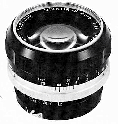

Uli's book also mentions a PC 35/3.5 with 7 aperture blades (they only have 6), and a change to the optical formula of the 105/2.5 which does not exist. He also speculates the picture of a prototype 55/1.2 is actually a modified 50/1.4 because the name-ring is inside the filter ring, discounting the possibility the filter ring might be 60 or 62mm, even though the proportions of the lens match the 55/1.2 and not the 50/1.4:
