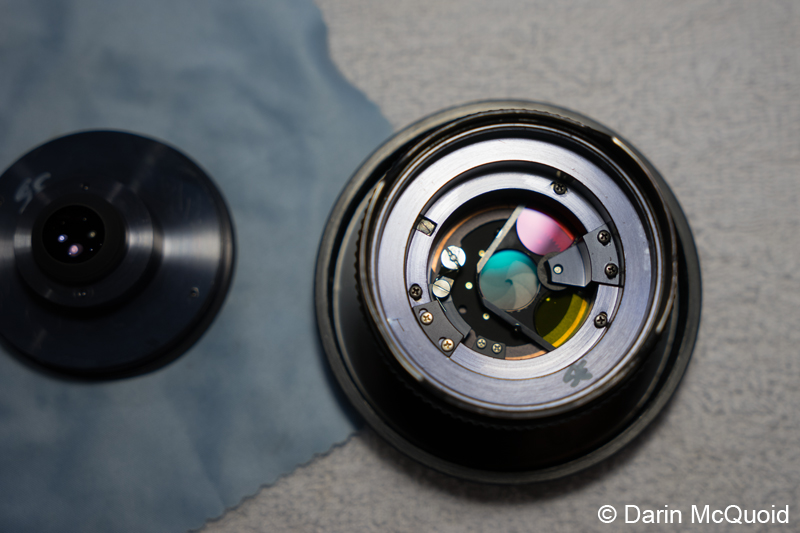

« Reply #15 on: November 15, 2016, 09:49:54 »
And as Bjørn said they are built-in so to "lose them" you need to open the lens and remove the filters.
Source
http://www.darinmcquoid.com/16mm%20repair.html
Arend

Thank you for the link!
The filters appear to be flat,,,
I have only opened the older versions F, Pre AI and early AI, this one appears to be Ai and different internally,,,
I also see Roland's page stating another build length,,, 60.5mm vs. 62mm
I'm pretty sure I have removed the build in lens hood from the front without further disassembly.

Thanks for the link, Arend. That's what the previous owner did.
I can now check if (hoping) the filter holding mechanism is still there. If it is still there, I have a chance to make a clear glass replacement, if I can get the thickness of the glass.
Erik, if the filter is a lens, should it appear on the schematic? http://www.mir.com.my/rb/photography/companies/nikon/nikkoresources/late70nikkor/fisheyes/16mmf35.pdf
Re: Nikon 16mm f/3.5 AI Lens Cap
« Reply #18 on: November 15, 2016, 10:56:58 »
The filter is plane and has no refractive power.
An incorrect thickness will move focus 1/3 of the difference in thickness between the original and its replacement. Thus, possibly except for infinity focus, getting the replacement thickness wrong isn't that critical as long as you  focus the lens visibly.
I probably have a spare A2 or B2 filter for the 16mm f/2.8 fisheyes, it should be more or less the correct thickness and any optician should be able to trim it to the required size. You can get it for a nominal cost to cover shipping.  The slight change in w/b should be no problem with a DSLR anyway.

Clearly the filters appear to be flat in the images of the Ai'ed lens,,,
What is your serial # ?

Just checked with my friendly Nikon repair tech.
The lens cap is not a spare part, it is a sales item. The filter wheel is part number 20FL16-007.
