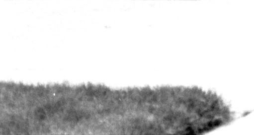

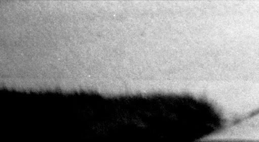

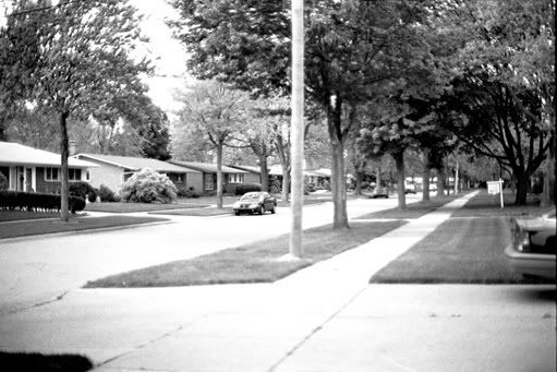

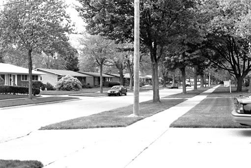

Back in the day, I did extensive tests with my very early (#5) AIS 50mm f/1.2.  I still have the results saved on photobucket.
From what I remember using it (I sold it a long time ago) is that it was very sharp in the center with a quick falloff of sharpness and increasing darkness of the corners wide open.  It improved substantially at f/2.8.
These were the results wide open;  (these are film scans fyi);
And then stopped down to f/2.8;
The corners were very dark wide open.  An example of the lower left corner wide open;
Here is the same corner at f/2.8;
I loved this lens and I sometimes wish I never sold it.  However, I understood its limitations - and if I kept those in mind it was a fantastic lens to use in specific circumstances wide open.
  • Posts: 2788
Re: 50 mm Nikkor shootout (2) : outdoors
« Reply #14 on: September 12, 2016, 05:35:39 »
Indeed, the vignetting of the 50/1.2 expresses itself in "dark corners", not very nice (the AIS version possibly being a tad worse). However, from my observations, some sharpness gets retained off center, while the "fogging" increases.
