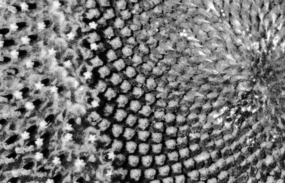

We have indeed come a long way. The quality improvement as far as rendition of detail is concerned is remarkable over the last decade. Concomitantly we have seen image resolution of our UV cameras rise from 2.7-4 MPix (Nikon D1H, D2H) to today's 24 MPix (Nikon D600). As the lenses such as the UV-Nikkor largely remain unchanged, we can attribute much of the increase in observed UV quality to the higher resolving cameras of today. Plus improved filtration plays an important role. Perhaps a tiny bit can be credited to learned experiences over the same time period as well.
To illustrate, here is a Sunflower in UV anno 2002 (taken with UV-Nikkor on a D1H). There is contrast loss due to IR contamination, an aspect scarcely recognised at that time but later shown to be of critical importance to the overall UV rendition. At the time a sunflower was considered to lack a "UV signature". We know now how unjustified that assertion was.
(100% crop)
