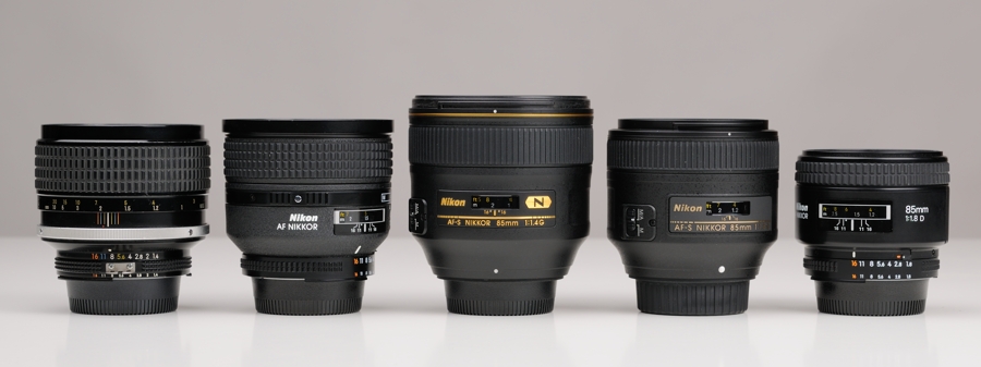

A few years ago (I think it was 2012) I compared the 5 different fast 85mm Nikkors (f1.4 and f1.8 )
Here is a group picture to compare the relative sizes:
(from left to right: AiS 1.4, AFD 1.4, AFS 1.4, AFS 1.8G, AFD 1.8 )

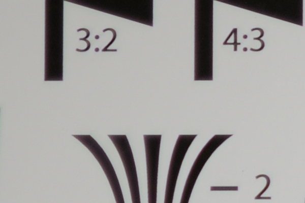

In these "old" days, I did more "comparisons" to figure out what the sweetspot of each lens was (probably better to call it curiosity). One of those tests was of course sharpness wide open (I am much more relaxed about this today)
This was the overall testchart
Here are crops of the upper left corner of all 5 lenses with their respective open aperture (Camera=D3x):
1) AiS 85mm/1.4
2) AF 85mm/1.4
3) AFS 85mm/1.4G
4) AFS 85mm/1.8G
5) AF 85mm/1.8 D
Please be aware, that with open lenses the impact of sample variation can be higher than with slower lenses. (Check for decentralization when looking for used ones)
