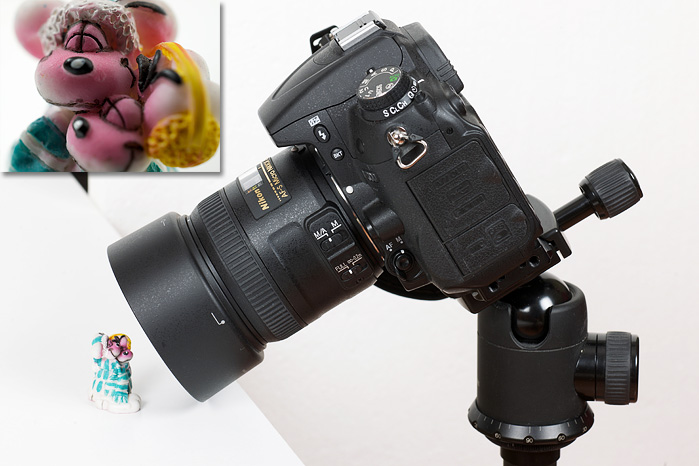

In many ways the 40mm is more convenient on a D60, with a great exception as already pointed out above: working distance.
Just to get a feeling how close you are at 1:1 - source: http://www.photozone.de/nikon--nikkor-aps-c-lens-tests/674-afs40f28dx
Arend
