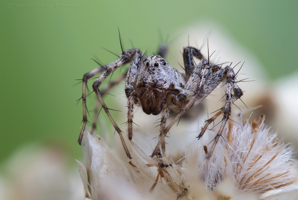

All images captured on a Nikon D810 + Nikkor 28mm Ai-S f/2.8 lens, reversed (at 2.1x magnification), using natural light.

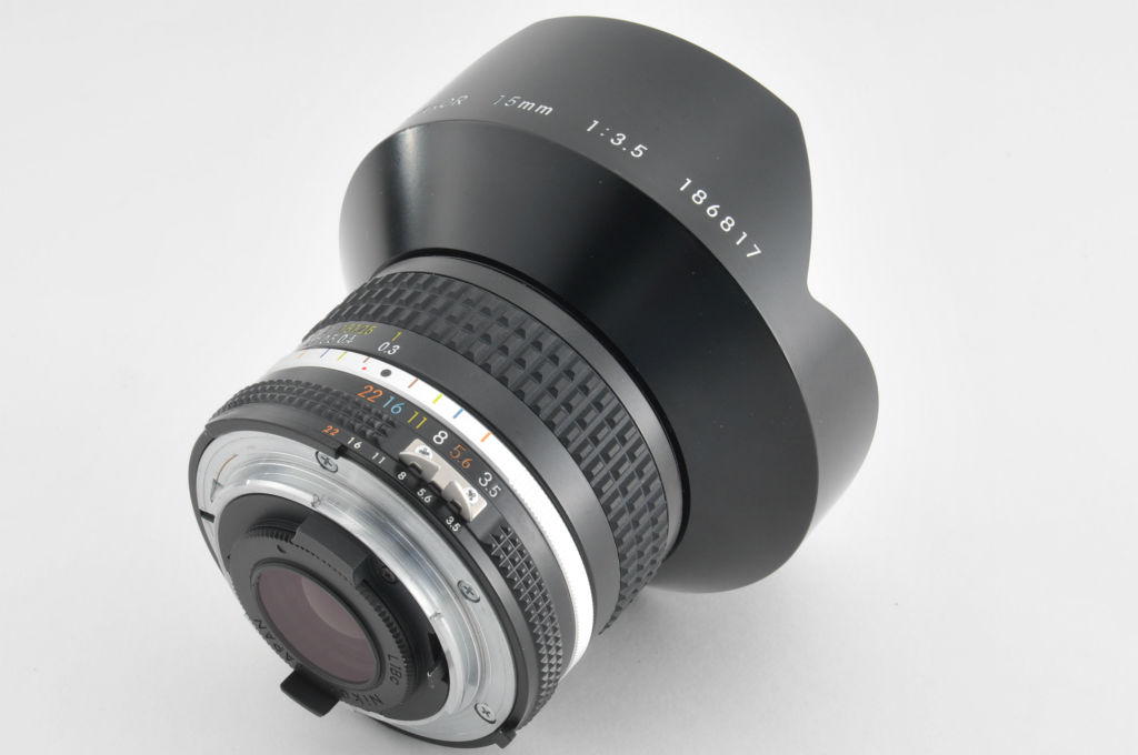

Chances are high that you will enjoy the 15mm/3.5 :)
rgds, Andy
At the suggestion of Andy, I also just picked up a copy of the Nikkor 15mm f/3.5 Ai-S ;D
While the leather case is a bit under the weather, the lens and filters are absolutely flawless.
Am going to the Grand Canyon this weekend, so we'll see how it fares.

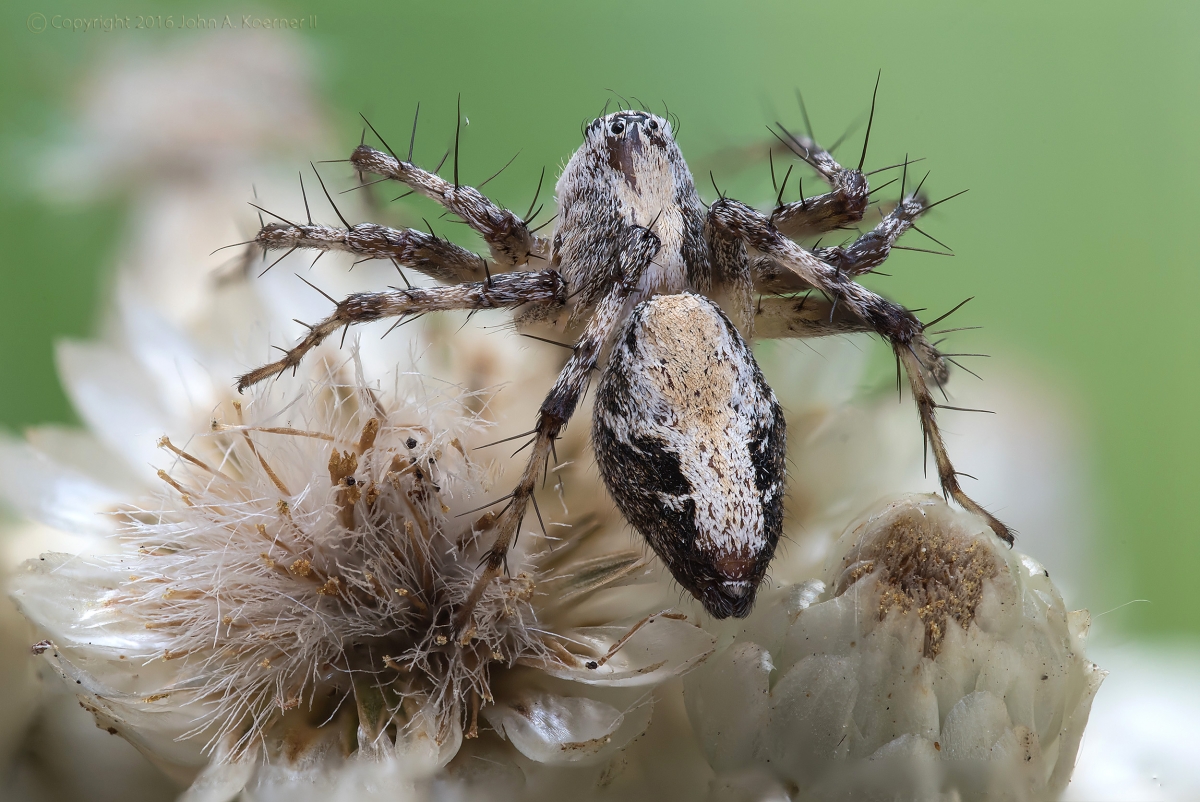

Outstanding spider pictures. What aperture did you use? Some years ago I tried using a reversed lens for greater than life size pictures, and found it was difficult to find the right balance between stopping down for greater DOF, and avoiding too much diffraction. For magnifications up to about 1.6x I use the AFD 105/2.8 micro on a PN-11 tube, the working distance and handling is much easier, but I'm not sure this lens qualifies as "old school" ...
John Koerner
Re: Old School Nikon Primes
« Reply #218 on: June 14, 2016, 23:39:03 »
Thanks, Roland.
I tend to fluctuate between f/8 and f/11, with both the Ai-S 28mm (at 2:1) and Ai-S 20mm f/3.5 (at 3+:1). The main thing I try to do is never go over IS0 320 using natural light (ISO 640 in the extreme).
I have read conflicting information on th Ai-Ses: one reviewer mentioning that you should always put the lens at infinity to "increase working distance" ... while another reviewer suggested using the closest setting possible, so as to trigger the CRC (Close Range Correction) feature of these unique Ai-S lenses.
I would have to agree with the latter suggestion, using the closest-distance setting possible, because I have enjoyed my results better this way.
The bokeh is buttery-smooth, even at f/8-f/11 apertures, just because of the extremely-shallow DOF. (All of these images are between 12- and 18-stacked images to get the focus range, so I get the best of both worlds: lots in-focus but still buttery-smooth bokeh. I almost never use flash. These images were at about 1/10 SS.)
Hope this is useful.
Jack
  • Posts: 1545
« Reply #219 on: June 15, 2016, 00:14:49 »
Thanks. It's worth stating that the aperture setting on the lens is only true for the lens mounted normally on the camera and focused at infinity. If the lens is reversed the aperture setting of f/8 probably translates to something like f/22 once you take extension and the different configuration into account. That's well into diffraction territory, but obviously good results can still be obtained. Focus stacking explains why you were able to get so much DOF. That's really good use of stacking as it looks natural, if stacking is overdone the picture is too sharp front to back and looks flat. It's amazing the spiders were still long enough for you do do it.
As for "focusing" the reversed lens, if the lens is unit-focusing (such as the AIS 20/3.5) it makes no difference optically. If you set the focus ring to infinity you gain a few mm extra working distance because the rear element is further to the rear (or front since it's reversed...) On the other hand if you focus close, the rear element retracts into the barrel so you lose a bit of working distance, but the rear element is better protected from knocks.
If the lens has floating elements (such as the AIS 28/2.8 ) then the setting of the focus ring does make a difference optically. With the lens reversed, if the subject - sensor distance is 0.3m, then the lens should be focused to 0.3m, so the optics are properly configured for that distance.

John, these spider images are simply amazing!  Thanks for sharing.  It is also surprising that you can stack more than ten images for these living creatures.  My amazement is doubled...
I almost never use extension tubes, as they degrade things rather quickly IMO.
I am not much at calculating diffraction-per-aperture, reversed, but rather just go by my eye.
My eye tells me that, with the 28mm Ai-S, f/8-f/11 apertures, stacked, give me buttery-smooth images (if I keep the ISO down) ... but at f/16+ I begin to notice unacceptable diffraction.
I agree; I don't like "everything in-focus" in most macro shots either, as the images look more like CGI graphics than artistic macro shots. I much prefer the fore- and aft-bokeh to macro imagery.
Regarding their standing still, these particular species are "freeze and ambush" spiders, so they're great for stacking. Once they settle down, they just sit there ... "waiting" ... It is only the species which are proactive hunters that are almost impossible to stack, but these guys, above, are a piece of cake :)
Isn't the severity of the diffraction effect in a given setup linked to the f-stop(geometry) and not the T-stop(transmission)?
« Reply #224 on: June 15, 2016, 08:59:58 »
Both, as magnification comes into play as well.  What Roland mentioned was the effective aperture which takes magnification into consideration. We don't denote this 'T-stop' or more appropriately, T-number, that relates to the nominal transmittance of the non-reversed lens.
Depth of field at high magnification is always a scarce commodity, whether or not one stops the lens down to the minimum aperture setting.
