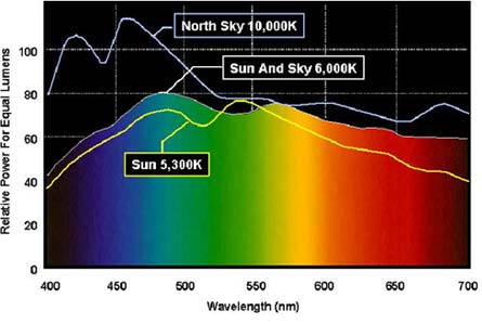

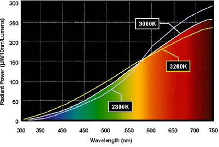

If you compare the energy density of different light sources, you might appreciate the impact the light source has on the overall color rendition
Daylight and moonlight
A bulb (thats why the blue channel is usually the problem child in white balancing these pictures - lots of noise in the blue channel due to much stronger amplification needed)

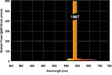

High pressure sodium lights are particular mean to WB attempts with RGB sensors - there is just no energy in the other channels
