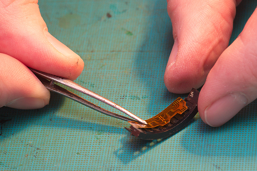

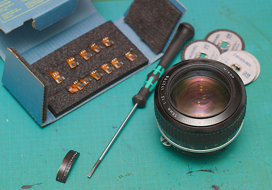

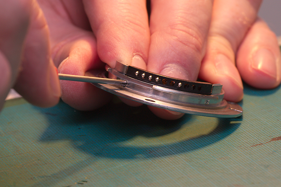

Today I flew down to Copenhagen, Denmark to team up with the Great Dane (Erik Lund, also known as Dr. Lens). With me, unable to object, was my Noct-Nikkor 58/1.2. It is slated to undergo CPU surgery ("chipping").
This is a documentation of a day in its life which might well be its last. Follow the sequel to learn what happens in near real time.
And, finally, the CPU assembly is completed, fitted into the mount, and checked to see that the read-out is correct.
This seems to come along nicely.

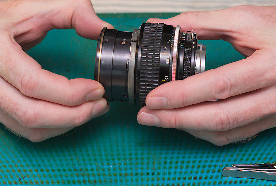

Now, ready for the gruelling Stage Two.

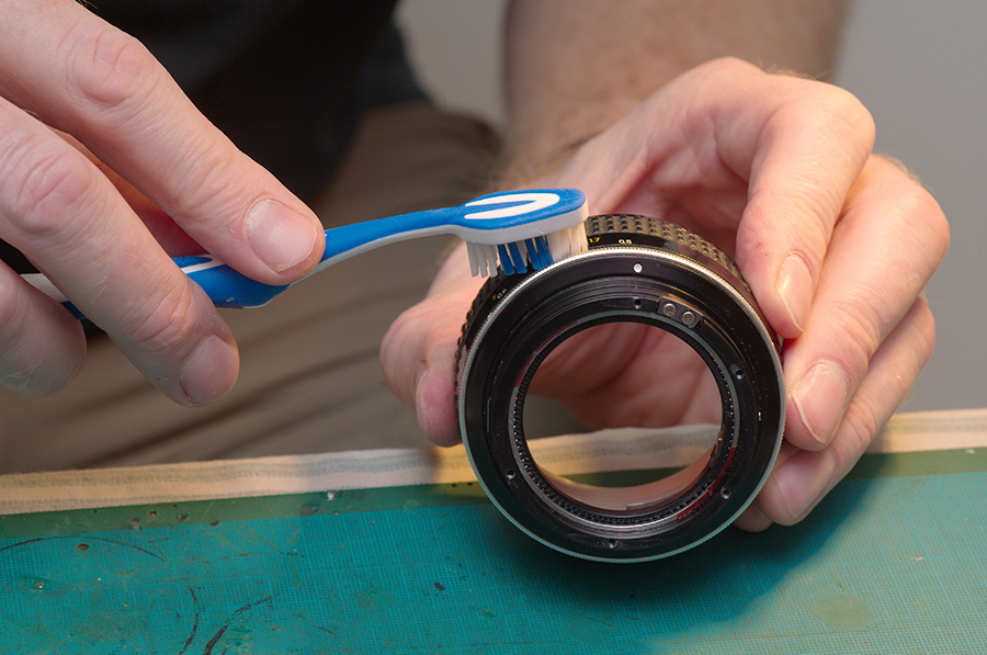

First, cleaning dirt off the assembly.

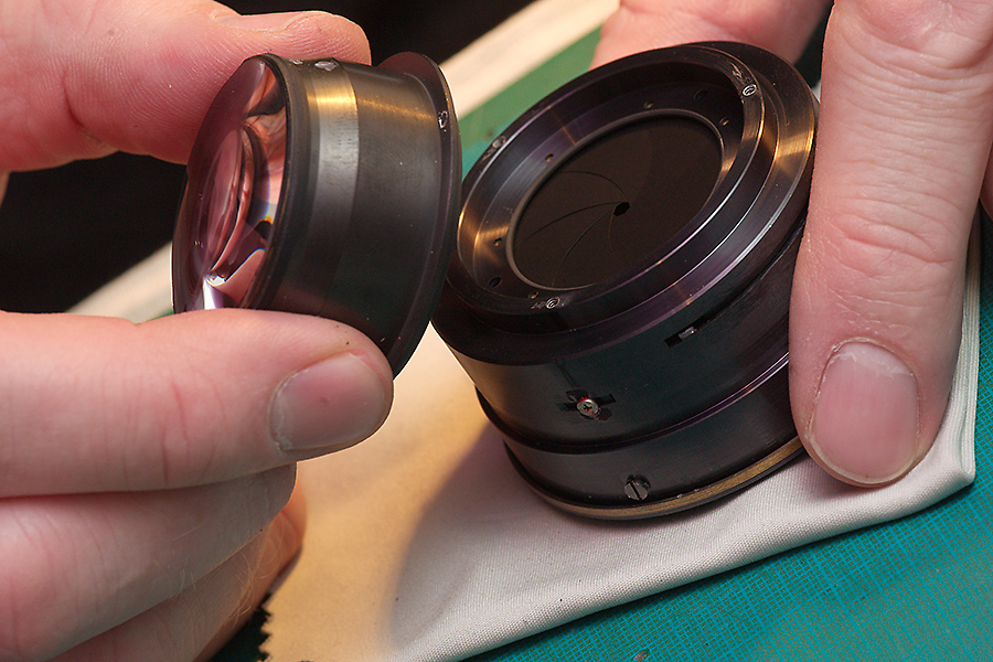

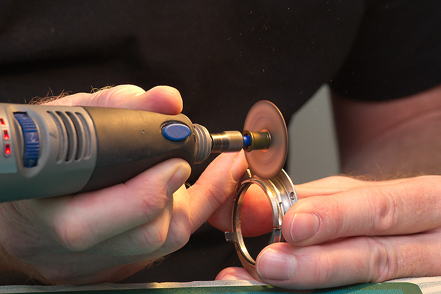

Then, split the optics at the iris.

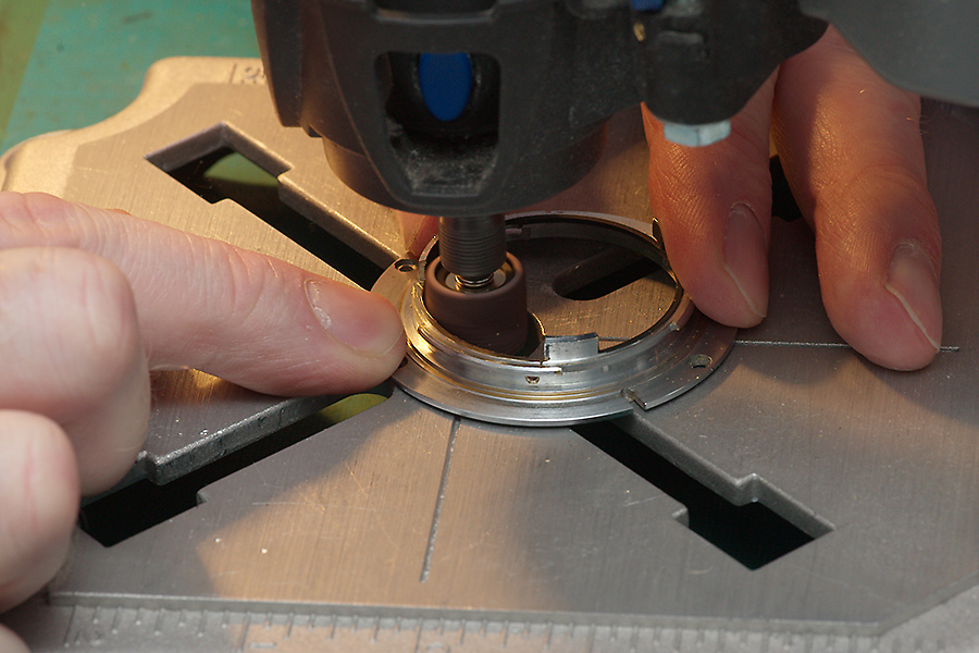

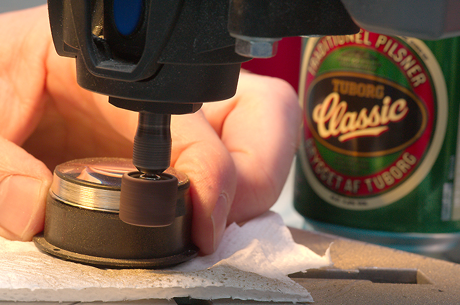

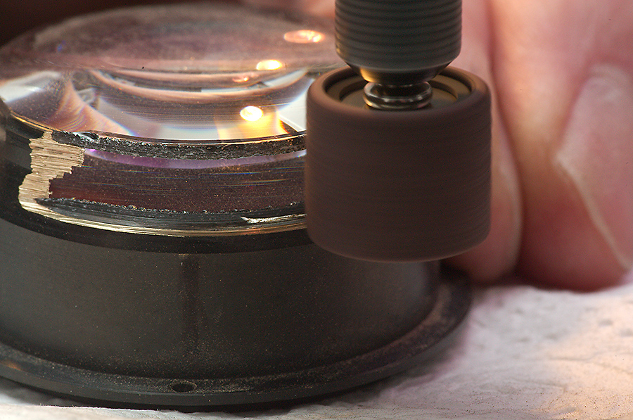

Critical phase is trimming the rear lens group. Not only part of the casing has to go, the glass itself has to be cut into. Beer acts as the cooling substance to help complete this operation.
Almost there now .... and well into the two rear elements as well ....

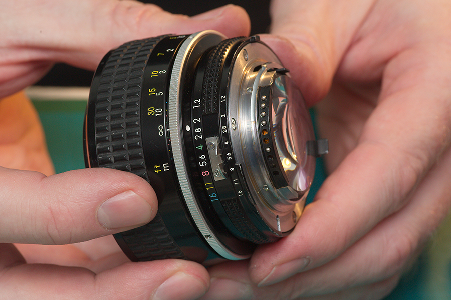

« Reply #2 on: June 20, 2015, 10:43:42 »

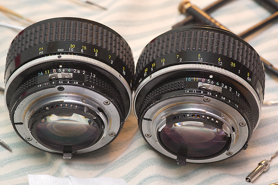

A little later, all parts of the Noct had aggregated again, and only the CPU pins disclose its recent surgery :)
Here they are, the only two known Noct-Nikkor 58 mm f/1.2 Ai [P] lenses. Erik's to the left, mine to the right.

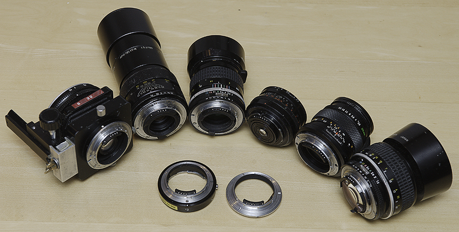

Here are the combined outputs from this "repair & shoot" workshop.
From left to right:
    28 PC-Nikkor Tilt/Shift, new focus assembly (old had worn-out parts)
    Leitz APO-Telyt 180 mm f/3.4, converted to "F" mount, CPU-modified, infinity calibrated
    Nikkor 85 mm f/2, CPU-modified
    Novoflex Noflexar 35 mm f/3.5 (original "F" mount, the rare version), CPU-modified, infinity calibrated
    Olympus OM 35 mm f/2.8 Double Shift, converted to "F" mount, CPU-modified, infinity calibrated
    Noct-Nikkor 58 mm f/1.2, CPU-modified
    BR-2 extension, CPU-modified (front right)
    E-2 extension, CPU-modified (front left)
Not bad for a few days (OK, so the working hours could be a "little" on the long side sometimes, but we had heaps of fun)

The story started actually more than a year earlier when I did the first chipping of my own Noct-Nikkor, it took the most hours of a weekend to do it, I had to re assemble the lens many times to get the parts in the right place to avoid interference with the CPU contact block and screws...
When I showed the lens when we met he just took it out of my hands and played with it on and off the next days, he handed it back with a quick remark; It works...
First then was I satisfied, since I knew the performance was identical with Bjørn's untouched sample, the rear group is super important and it had been taken apart and reassembled several times...
That's also kudos to the Nikon design team to be able to make the tolerances tight enough for overhauling/repairs.
But then I had a new challenge; Bjørn started asking if I would 'Butcher' his Noct... Recalling the frighting feeling of grinding the rear elements with a Dremel grind, sparks and small glass particles flying... well in the end I gave in as you see above :) But only because Bjørn was willing to go all in :)
