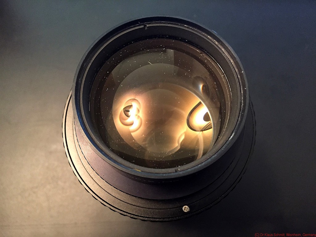

Thanks, Klaus, for the details of the adapter.  Hope the filter I intend to use is of a thin-frame type.
I have been told the max. thickness (w/o thread, just frame height) is 5mm (not too bad actually), max. outer filter diameter 54mm

Just one CAVEAT: there has to be ALWAYS a filter inside as otherwise there will be significant focus shift, based on the old Astronomer's rule, Focus Shift = 1/3 Filter Thickness, so a 2mm thick filter will shift focus 0.6mm backward.
As I use filter (stacks) of different thicknesses, this is a major drawback. Using gel filters would solve that (as those are very thin and not made of glass), but not possible for my type of photography.
AF shooters will have the camera balance this out most likely, but for MF it is cumbersome, especially when using a color corrected quartz fluorite lens w/o focus shift.

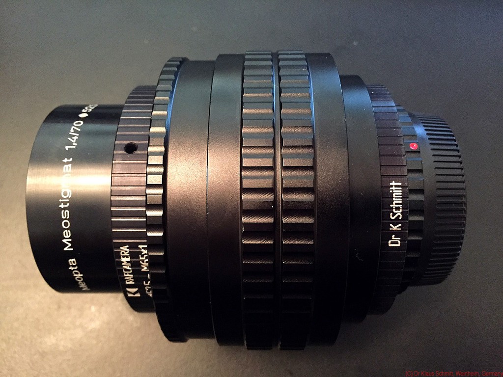

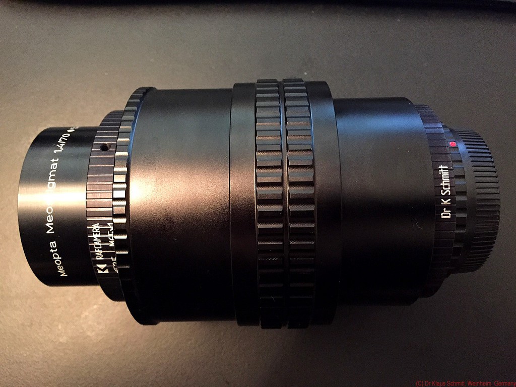

How to mount a projection lens, front adapter can be changed, as well as rear (can be basically any camera).
Works from infinity (depending on lens back focal length) to very closeup. Setscrews allow to calibrate the infinity position.
Lens --> Lens Adapter to M65 --> M65 to M42 Helicoid --> M42 to Camera mount Adapter
It is not a slim elegant and lightweight solution, but the benefits are:
1) no lens modification needed
2) very durable
3) non rotating front
4) accepts a variety of lens types and lens diameters
5) allows a variety of camera mounts
6) needs only about 15mm net optical length (plus camera register) for lens diameter 62.5mm or smaller
7) safes money and time for not having to go to the gym, as it is quite heavy :-)
The design is basically made to accept 35mm film russian projection lenses with a standard 62.5mm diameter.
Smaller ones (52.5mm etc.) are possible using a different front plate, also some larger ones, but infinity focus
may often not be reached using the latter, as such lenses cannot dive into the helicoid.
The M65 helicoid is made in China and may be found on ebay.
Those two adapter rings (front and back) are made by rafcamera.com based on my design.
The front one has three hex nut setscrews which hold the lens in place and allows to adjust infinity focus (only if the lens has enough back focal length)
Rafcamera offers several camera adapter plates for the rear one incl. Nikon-F.
Orders may be done directly through their site or through amazon.com
http://www.amazon.com/s/ref=nb_sb_noss?url=search-alias%3Dphoto&field-keywords=rafcamera+M65&rh=i%3Aphoto%2Ck%3Arafcamera+M65
(I have no connections with them except that I'm a happy customer...)
[my name is on the rings was a curtesy of rafcamera and is a non standard feature]

Well any parts will work as long as you follow the principle idea. Rafcamera also offers these,
as it basically has been turned into a "product" by him, which many now use as the hype for
using fast projection lenses is still on..
Mine still is this, but many helicoids are on the market now...
