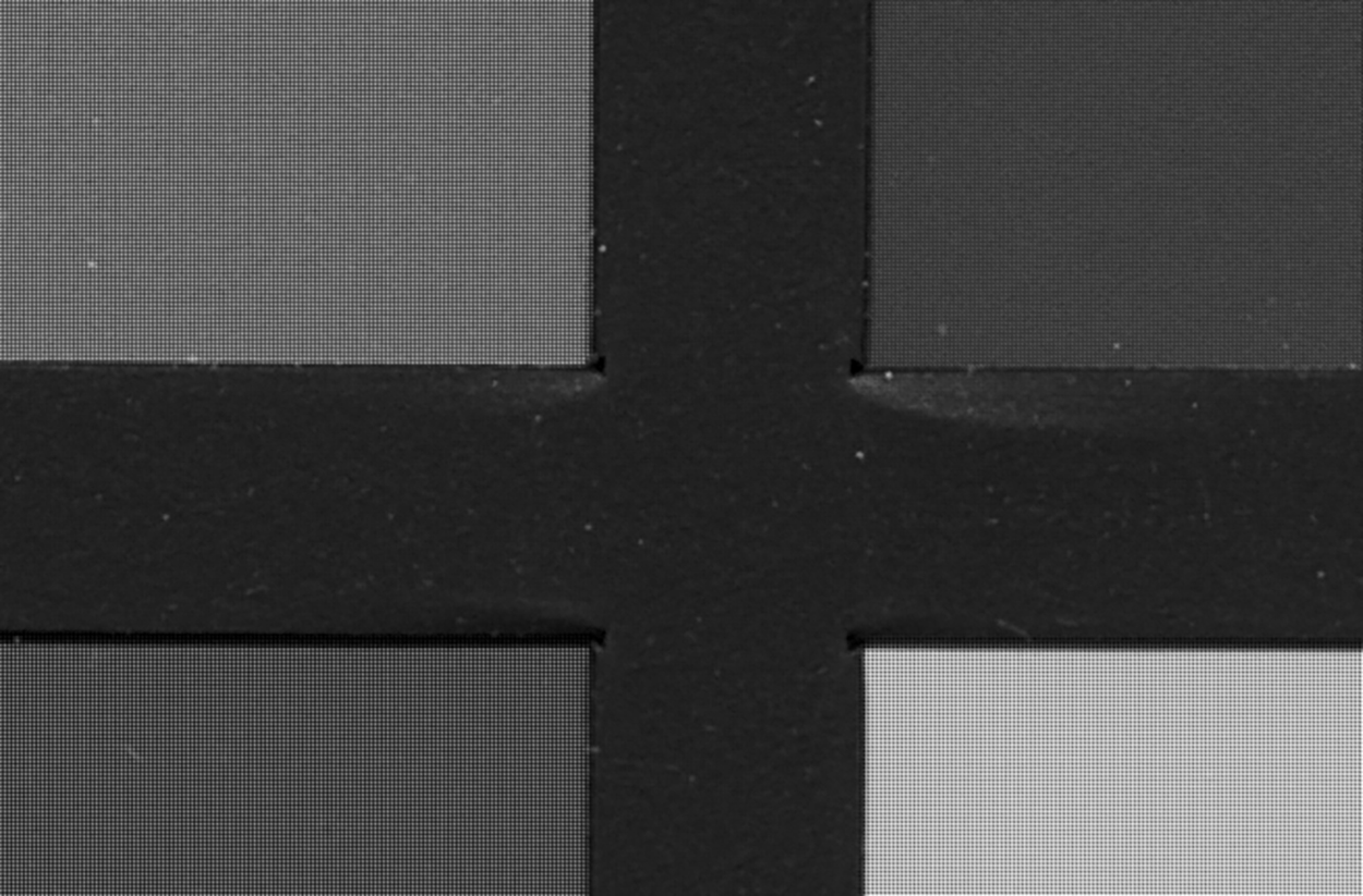

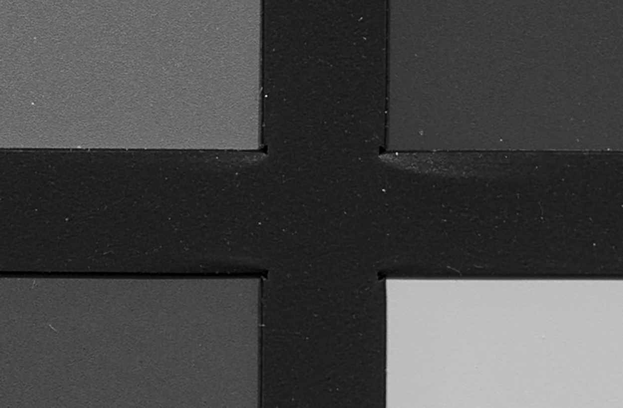

300% crop - unfortunately i get aliasing on the checkerboard pattern but you can see how much sharper the D800 monochrome conversion is.
Stock
Monochrome Conversion

This tread clearly shows how you get better accutance with a monochrome sensor. But to me other advantages is not so obvious? Leica i said to produce a picture with better tone values and beautiful greytones in their monochrome sensor, but from the pictures I have seen the accutance seem to be the largest benefit just as with the monochrome D800. I have a fullspectrum D600 and an ordinary D800. My largest prints are typically 50 cm x 75cm (the best gallery size imo) and both cameras fullfill this giving me enough accutance even cropped in B&W conversions. A bayer sensor gives you the advantage of skipping filters. To me it seems different software can make more differences than just a monochrome sensor, so I have stuck to lightroom/photoshop for my B&W conversions because I have learned the software... But since I never have used a monochrome sensor, I might be wrong? Any comments about what to gain except for accutance trying out a monochrome D800 in my photography?
