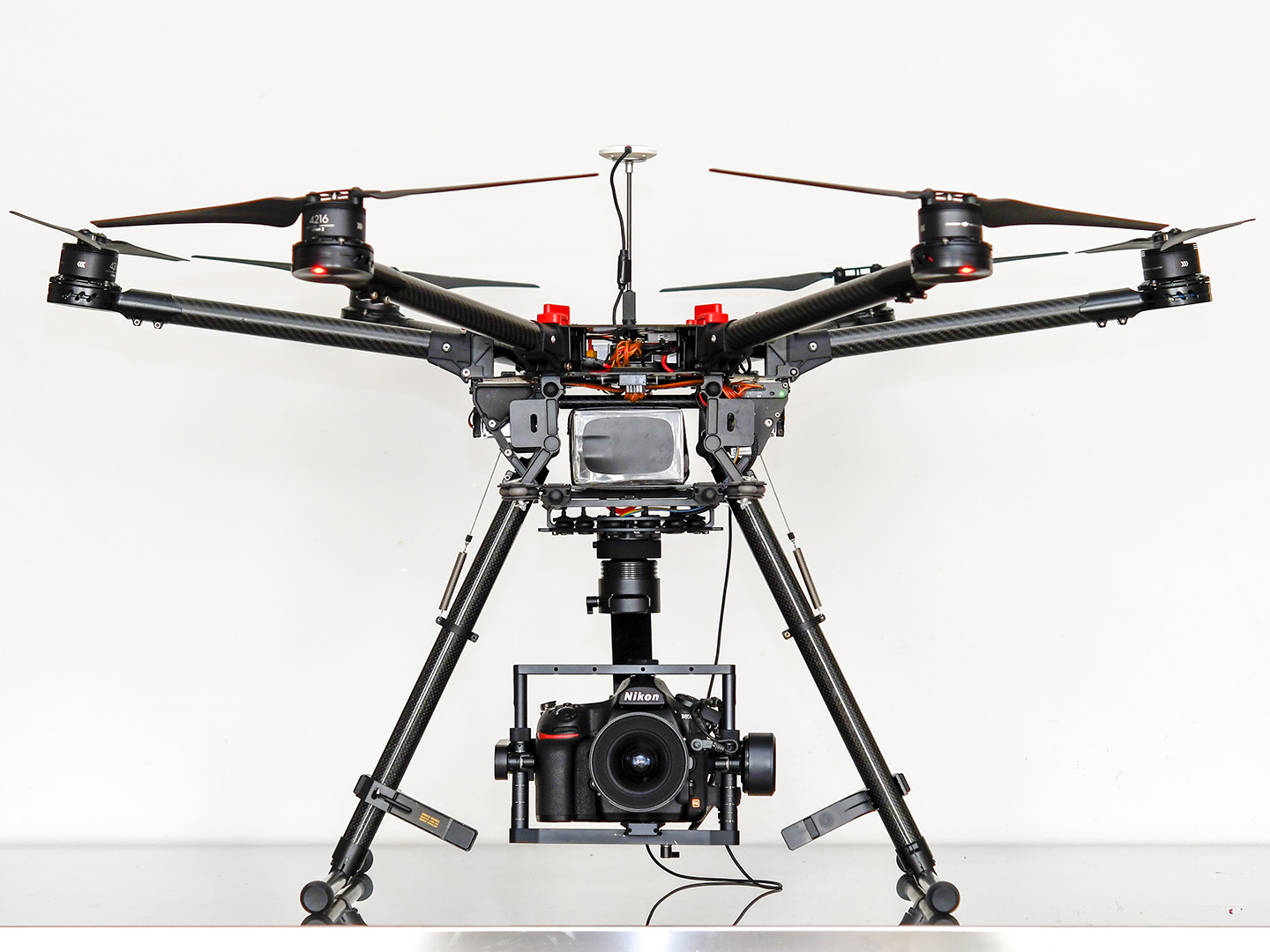

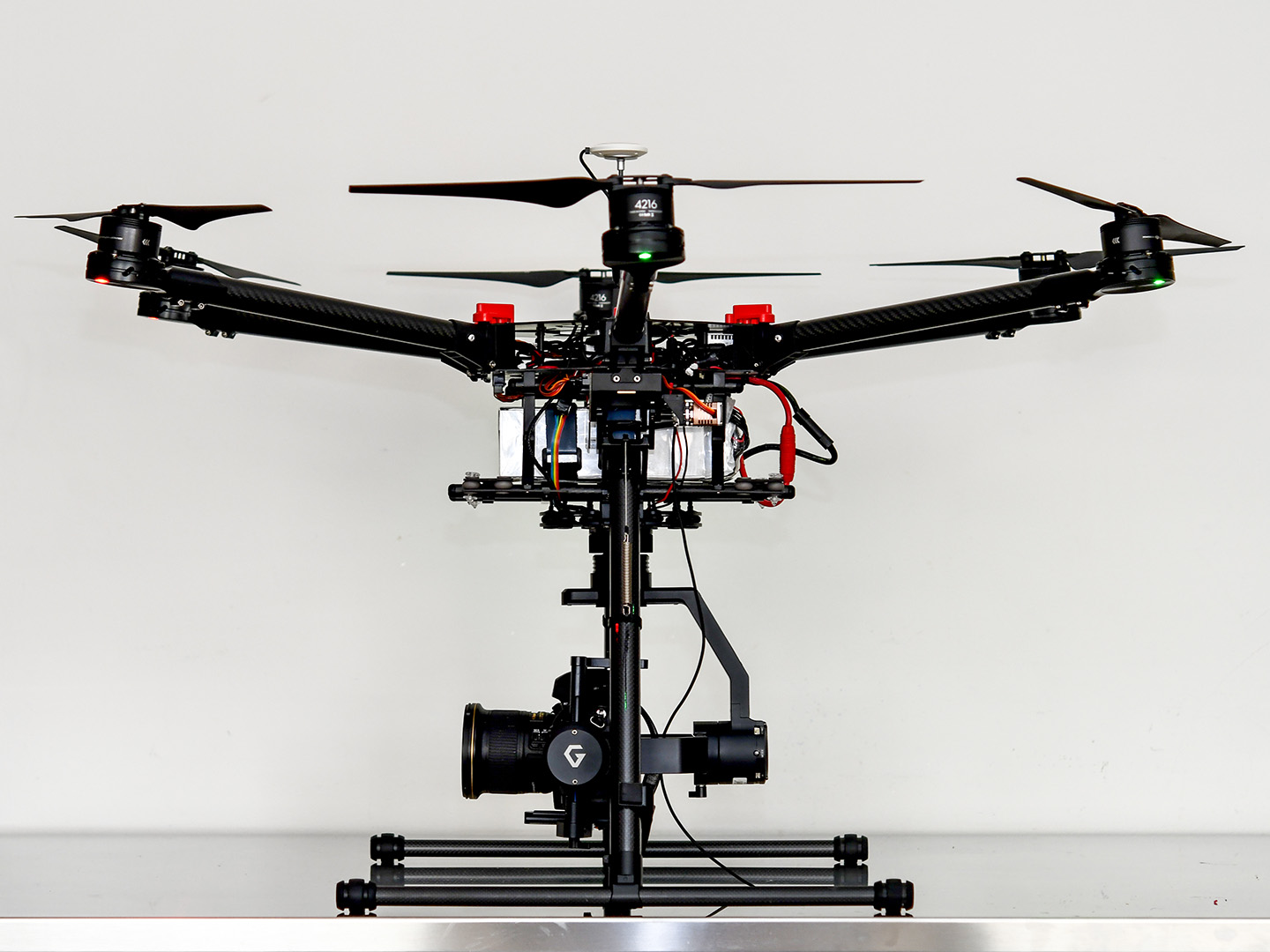

here's the overall aircraft:
it's a few remaining pieces from the original DJI s900 (hardly any, lol) plus their e1200 propulsion kit, a reinforced top plate, custom extended landing gear legs, n3 flight controller, lb2 video link, third party gimbal, etc.

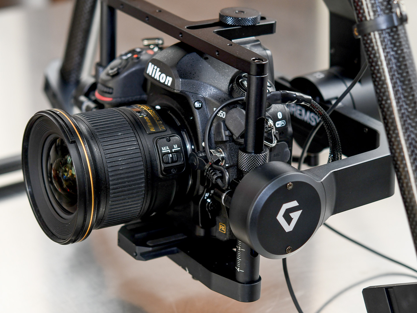

the camera is really why i built this guy rather than buying one of DJIs high end setups. i already have a d850/d810/d500 and a ton of lenses, so zero cost. short of medium format, it's the best still image quality you can get for this kind of shooting. i've shot with the 20 f/1.8, 28 f/1.8, 35 f/1.8, 50 f/1.8, and 85 f/1.8. it's very easy to switch between these lenses, just change lens and slide the camera forward or back a tiny bit, and get back in the air.

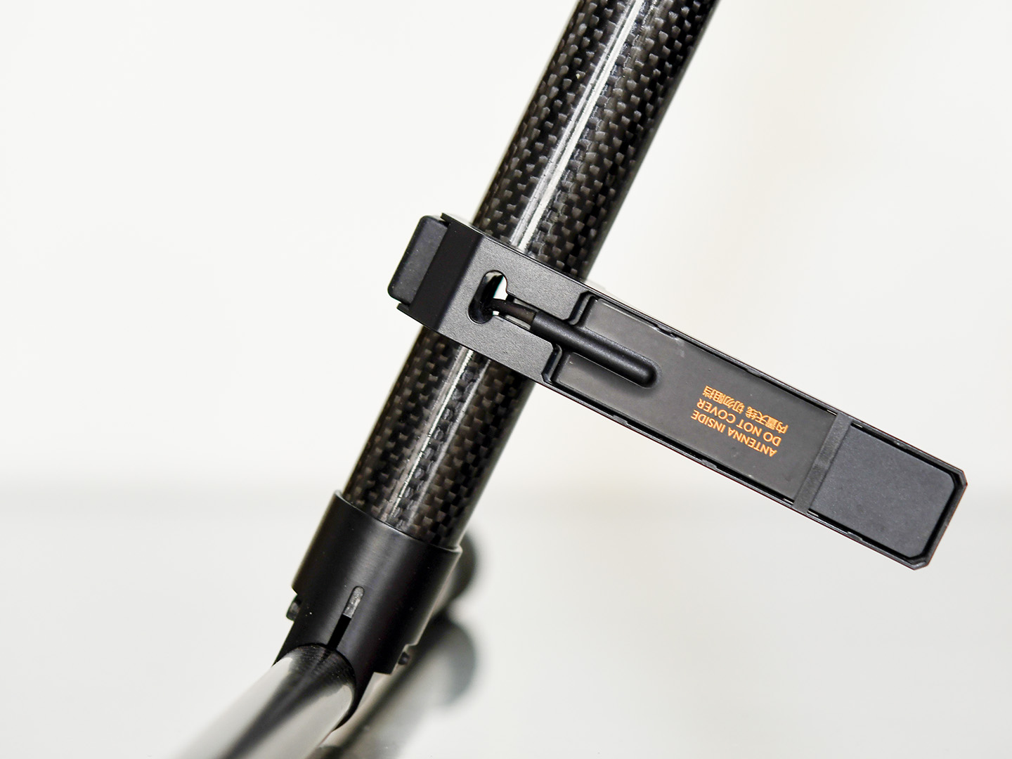

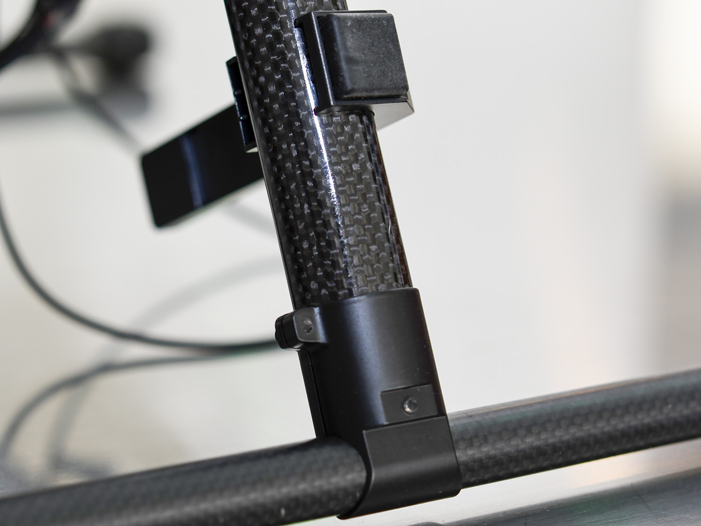

the radio and fpv solution is DJI's lightbridge 2. i did not like the loose antenna wires going up the legs, so i integrated an antenna kit from one of DJI's more recent drones, the M600. all this takes is two oblong holes in the legs plus two holes in the cap plate of the landing gear bracket, then you can route the two antenna inside the legs and into the frame. nice and clean, taking care to make sure the antenna wires don't get crimped when the legs fold up.

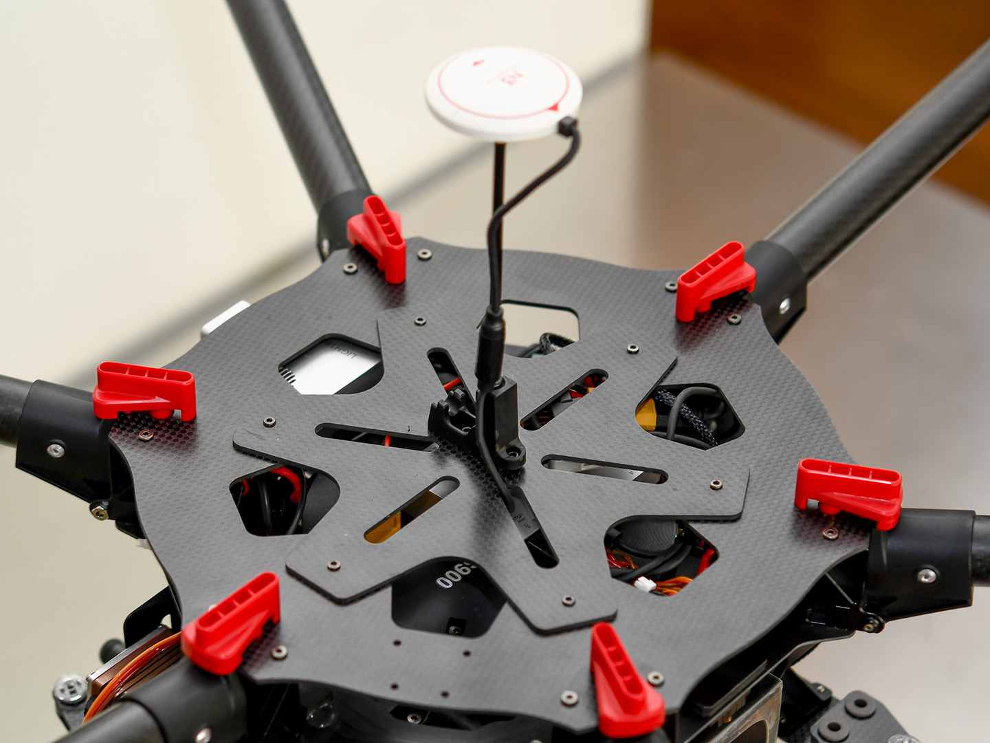

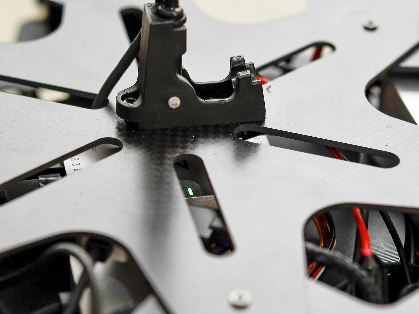

i don't like anything mounted on the top plate besides the gps, which i prefer to be in the very center.

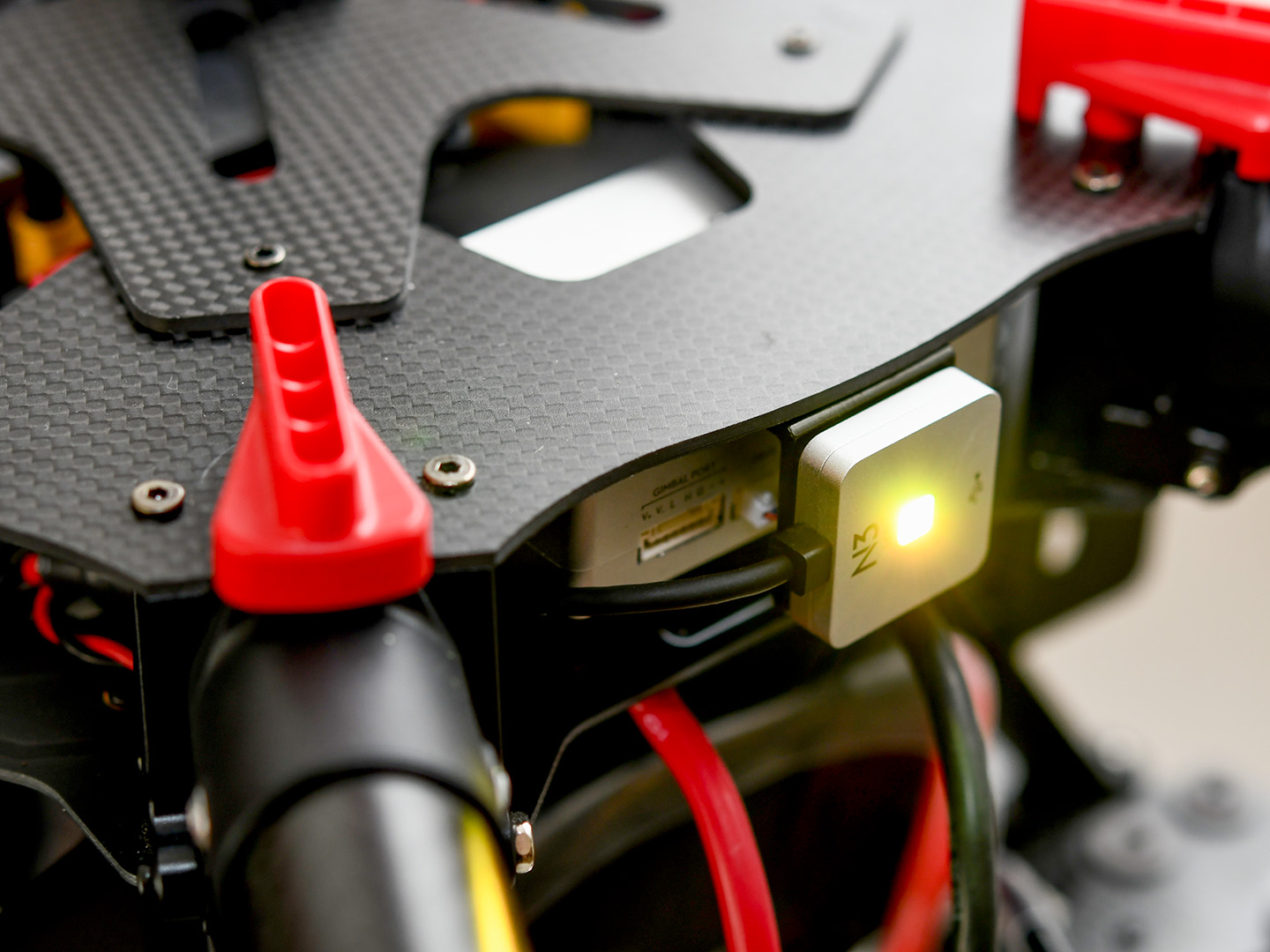

the n3 flight controller is mounted dead center on top of the plate which covers the power distribution wires, not really visible here. i'm not totally thrilled about this since that plate is very thin, but it's not going anywhere.
the lb2 which is both up/down radio link is on a little standoff in the back center. it needed to be lifted up slightly to fit. this it the hardest thing to fit inside the frame because of the antenna connections and hdmi cable, but it works. the led is on a little aluminum l bracket attached to the underside of the top plate.

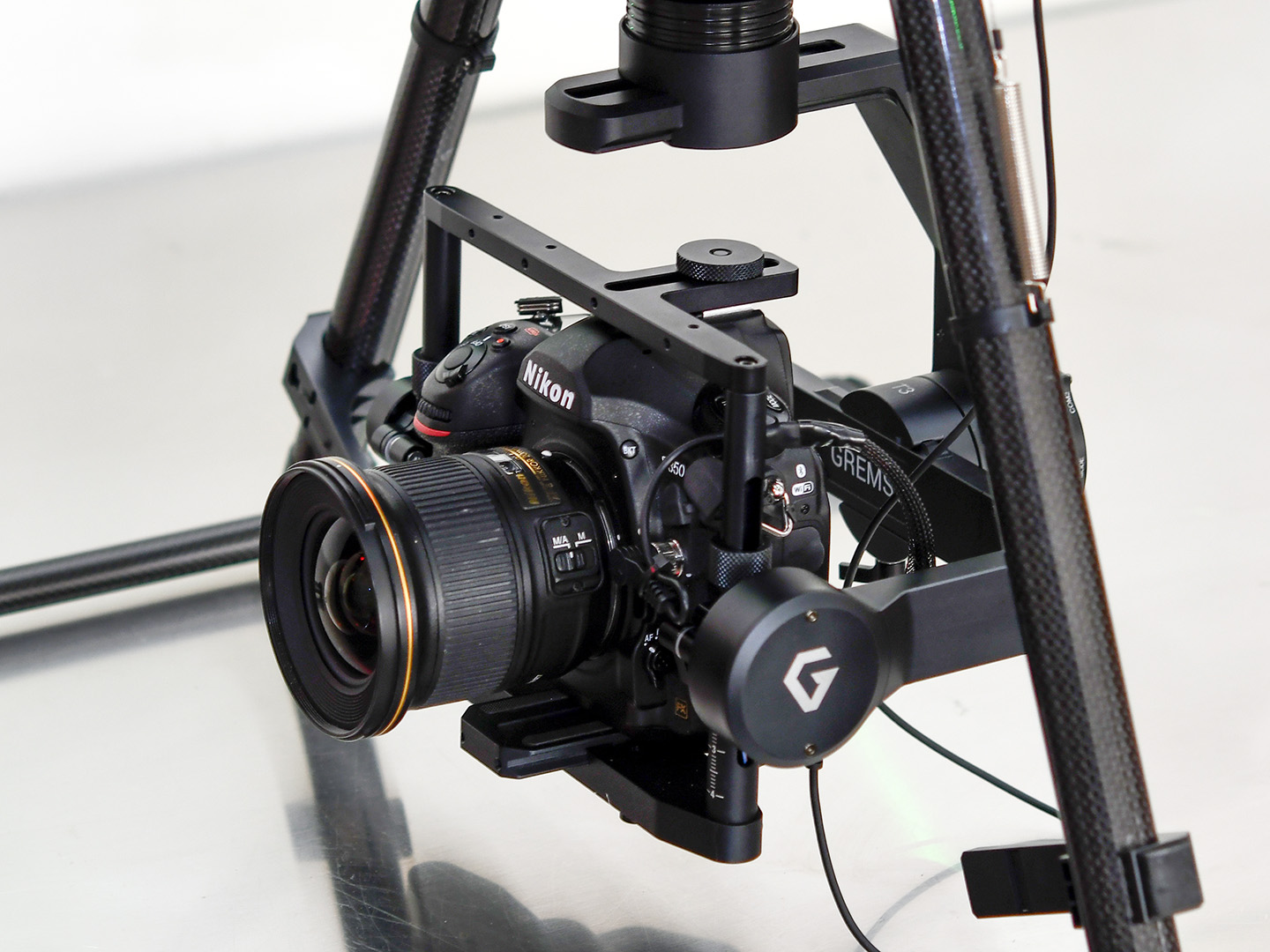

the shutter control is routed from an f port on the n3 (only one pin is used) through a spliced cable to the aux port on the aircraft side of the gremsy quick release. the gimbal then routes it internally, and then from a similar aux port on the camera plate. i needed a shutter control cable for this particular nikon remote port, a very old fashioned screw in connector. power is not supplied from the n3 f ports, so i spliced in the power from the gimbal itself. this is a weak point of the setup - all i get is "shoot," which focuses and then shoots.
the other weak point is the hdmi cable. the gimbal doesn't route the hdmi signal through the slip ring, so i used an ultra thin hdmi cable which just hangs loose. doesn't seem to have any effect on gimbal movement, but not pretty.
it flies fairly smoothly in both GPS and ATTI modes. the video image on the ipad connected to the LB2 remote is very high quality, 1080p or 720p, and the gimbal control from the remote is smooth and easy. the left back wheel controls the gimbal and can be switched from pan to tilt with the adjacent button.
with the tattu 22000 mah battery pictured, flight time to ±20% charge is 22 minutes fully loaded. with a tattu 12500, it's 14 min. i actually think the sweet spot might be somewhere in between there, and with a very slightly lighter camera. i might try a different camera with something like the maxamps 17000, which has an excellent power to weight ratio.
