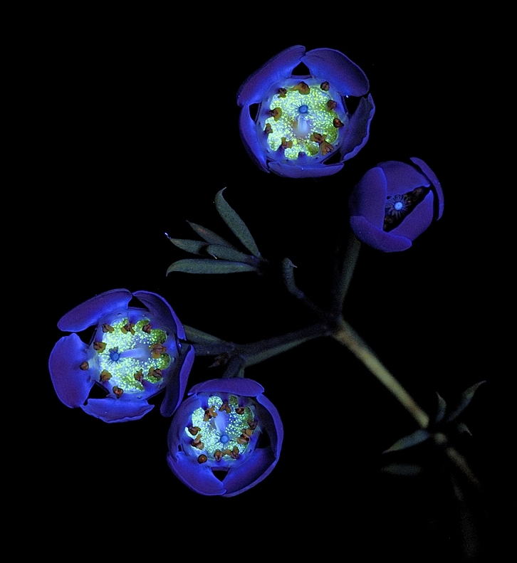

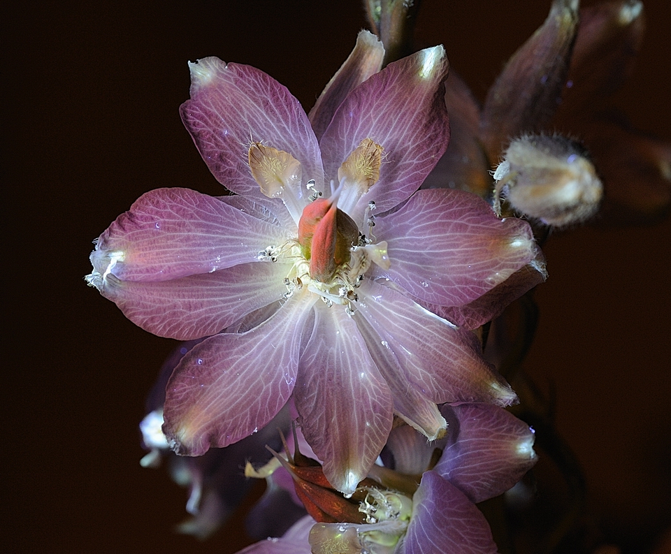

I use a 365nm UV torch called Tank007 bought from ebay to induce the visible fluorescence.  The torch emits a slight amount of visible light which is cut by a Baadar U (UV bandpass) filter.  You need nothing special on the camera or the lens, not even L37/39/41C filters, so long as the UV light source contains no visible portion, and you take the pictues in the total darkness.
Here's another humble example: UVIVF Oncidium.
Akira, can you be more specific? I'm not sure which mode flashlight one should buy and I'm looking at fillers that coast $300.00 to $400.00 (USD). This is a fright fest!
